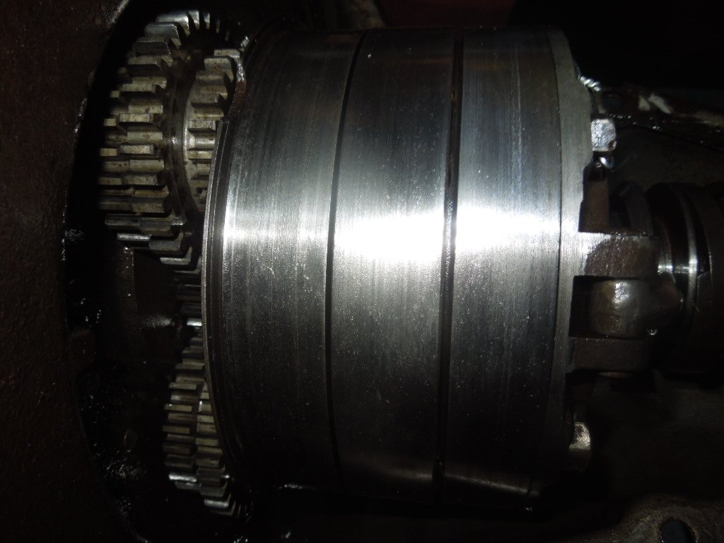

Here is a pic of inside the trans.
Can anybody suggest a oil that is too slippery when first starting but is fine when everything is up to temp? I remember another post years ago where there was an oil discussed that behaved like this. Would be keen to try as waiting to drive off is better than jacking up every time as long as there is no long term risks.
[attachment=1]Inside cover.JPG[/attachment]
[attachment=0]DSCN1199.JPG[/attachment]

As much as that brake band spring is compressed, I'd venture to say you're too tightly adjusted, lining about done and or brake pedal could have "whonky bent" issues.

Steve - I have wound the brake back but now I have virtually nothing, lucky I have a great handbrake.
I'm hoping the brake lining is simply worn down, easy fix but it looks ok. Not sure if you could could tell when it's worn by the eye?

I removed the Hogs head by myself yesterday. Decided to replace all the bands, I intended to do it with HH in place but I couldn't see how to clear the pin and spring to allow the ear to be removed and then spin the brake band out? Remember this is RHD so the brake is an external adjuster. Anyway too late now its off.
After removal the Brake band looks more worn now I have it out so I'm hoping a new band will rectify and the brake drum feels the same diameter when running finger over them as the others so I might be in luck.
What it has done is provided some pics of inside the trans, maybe someone can see a potential cause for the binding?
I will reline the shoes today and finish cleaning all the surfaces.
I haven't removed or refitted a HH before so I would appreciate your experience and suggestions for the refitting process-
I have both felt and neoprene seals for the front arch on hand, what do you suggest and what sealant and/or method would you use. Would you run sealant on both sides if you used neoprene?
The same advice is appreciated for the ordinary base gasket and preparing for the refit.
Thanks in advance

- Posts: 4847
Re: Transmission binds when starting cold?
Dress the sharp edges of that chunk missing from the low drum.
- Posts: 1454
- Last Name: van Ekeren
Reverse drum.

I see that chip out of the drum but I am reluctant to grind it smooth as the filings will end up in the trans.

- Posts: 4847
Sharp edges will cut the edge of the band faster.
You can place magnets around the area to pick up the flying chips.
A few loose powdered iron bits wont hurt your motor. Minimize to be on the safe side.

Thanks John but will they hurt the mag if any get into it?
- Posts: 4847
The field coil should have all the insulation it needs to keep metal dust from shorting it out. If not, during the natural wear in the motor, shorting would occur anyway.
The magnets will naturally pick up iron dust from cylinder wear, yes minimize it. Your magnets should have some now, unless you already wiped them off. Stuff that doesnt stick to the magnets will end up in the bottom of the pan or to your transmission oil screen magnet. The fuzzing of band lining concerns me more than a few bits of iron dust.
Another method I use when drilling balance holes in a flywheel with charged magnets is to set a shop vac nozzle close to where I am drilling to suck away the chips as they are produced. This makes for minimal dust sticking to the magnets, which I wipe away when done.
Using hand files in your case will maximize your control of the chips as opposed to a die grinder.
