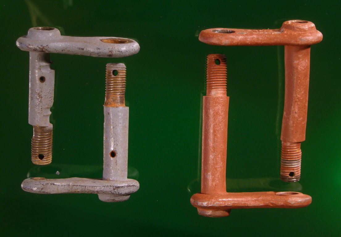

I have received the bushings and new bolts for the tie rod replacement. I tried to push out the bushing without taking off the spindle arm by placing a jack under it so I wouldn’t bend the spindle arm. Bushing didn’t seem to move. I took off the large 7/8” nut on the spindle arm figuring that I would have better control if I put it in a vice. That nut was very tight, needed extension on the wrench to loosen. From what I’ve read that is good. Left the nut sticking out to drive the spindle arm out, whacked it with a piece of wood on the nut, no movement. Put penetrating solution on all components and walked away.
Questions?
How does one get the spindle arm out without messing up the castle nut?
Can you replace the tie rod bushings with the spindle arm attached?
If the spindle arm is taken off to replace the bushings how do you put it back with the proper alignment?
Should the spindle arm move during normal travel?
Wanted to change out these parts before my mentor comes back from his vacation Friday! Don’t want to make the job worse because of ignorance.
Picture of current condition.
Questions?
- Posts: 4082
Re: More death wobble
Buy this tool. If you don't want to have it around afterwards, sell it in the Forum classifieds.Bobbbenner wrote: ↑Thu Jul 14, 2022 9:33 amI have received the bushings and new bolts for the tie rod replacement. I tried to push out the bushing without taking off the spindle arm by placing a jack under it so I wouldn’t bend the spindle arm. Bushing didn’t seem to move. I took off the large 7/8” nut on the spindle arm figuring that I would have better control if I put it in a vice. That nut was very tight, needed extension on the wrench to loosen. From what I’ve read that is good. Left the nut sticking out to drive the spindle arm out, whacked it with a piece of wood on the nut, no movement. Put penetrating solution on all components and walked away.
Questions?
https://www.modeltford.com/item/2714DR.aspx
With the arm supported properly, you can use this driver, along the hammer of your choice, to drive out the bushings. BTW, leave the spindle arm in the spindle. They can be a bear to remove and not necessary.
- Posts: 420
- First Name: Miles
- Last Name: Bowen
- Location: Brighton, MI
It would be a lot easier just to remove the wheel, unbolt the spindle from the axle, then use the tool Jerry mentioned at the bench. That way you won’t have to worry about getting the arm alignment correct.

Bob: I had good luck using 3/8" threaded rod, washers and nuts, and a 3/8" drive deep well sparkplug socket as a 'puller' to draw the new bushing in while it forces the old bushing into the cavity of the socket. The cavity of the socket must be large enough for the o.d. of the old bushing to fit inside but small enough so the edge of the socket sits squarely on the arm. Alignment of the new to old bushing is critical, and it helps to relieve the outer 'corner'/circumference of the new bushing where it enters the arm. Bushing to bushing alignment is easier if you use a sleeve with 3/8" i.d. that fits snugly in the bore at the juncture of the new/old bushing. Once the new bushing enters the spindle arm hole the alignment is maintained. Oil liberally once you have things aligned.
Alignment on the exit side is important too so the old bushing has a clear pathway into the socket. This technique has been shown repeatedly for similar situations on the forum, so it is a familiar low tech solution. I would place the new bushing on top of the old in the arm, then insert the 3/8 rod with the alignment sleeve, top washers and nut downward and slide the socket up from underneath, place washers and nut on bottom, align socket, oil and wrench
Do not remove the spindle arms and I prefer not to beat bushings in/out even with the so-called 'drivers'. If you resort to a two step -- (1)remove old then (2) insert new, the threaded rod/bolt, nut and washer 'puller' to insert new one is still superior to beating it with hammer and 'driver'. (And from my experience, you will likely need to ream the new bushings slightly to get yolk bolts to fit arm bushings once they are installed.) Good luck, jb

If you have a press, remove the spindle. Use the bushing driver tool or equivalent in the press.
If no press, this threaded rod with spacers & bushings will do it.

The simplest way to re-align the spindle arm if you do remove it is to leave it loose in the spindle as you refit it,. Then hook up the tie rod and it will dictate the correct alignment. Only then do you tighten the spindle arm nut.
- Posts: 4082
True! Also allows you to inspect the kingpins and wheel bearings.
- Posts: 6262
Steve Jelf DIY bushing tool. Smaller tube OD same as bushing wall OD. Larger tube acts as an anvil large enough for a secure base but its ID needs to allow the bushing to slide into it. Adapt parts to fit your busing needs.
