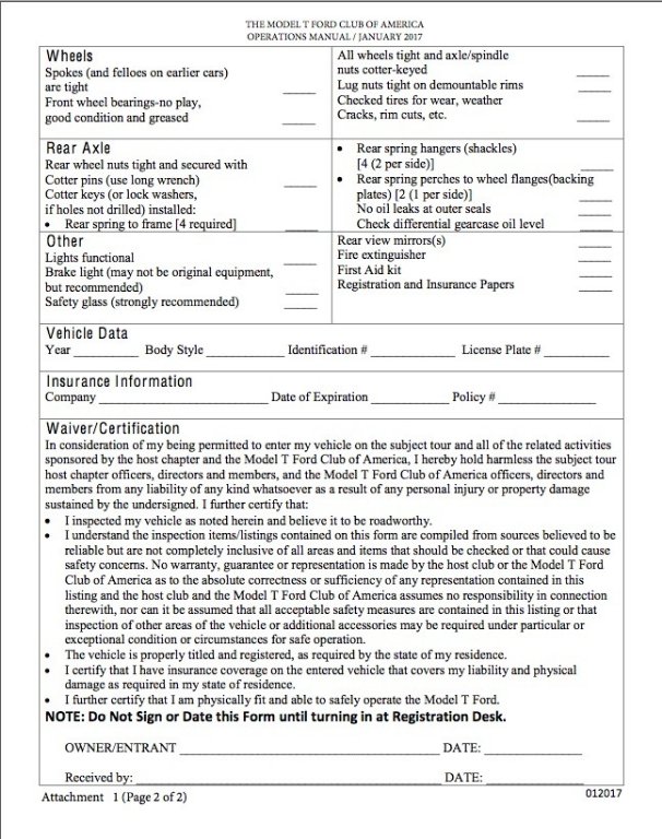

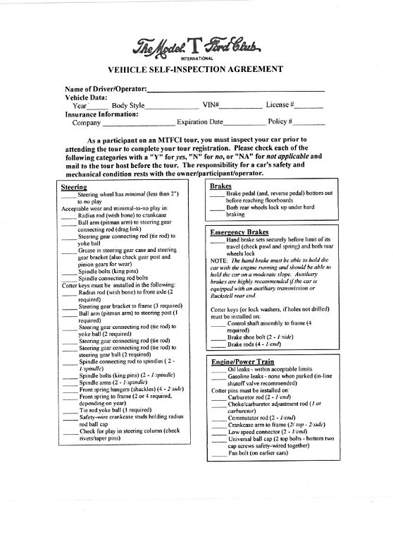

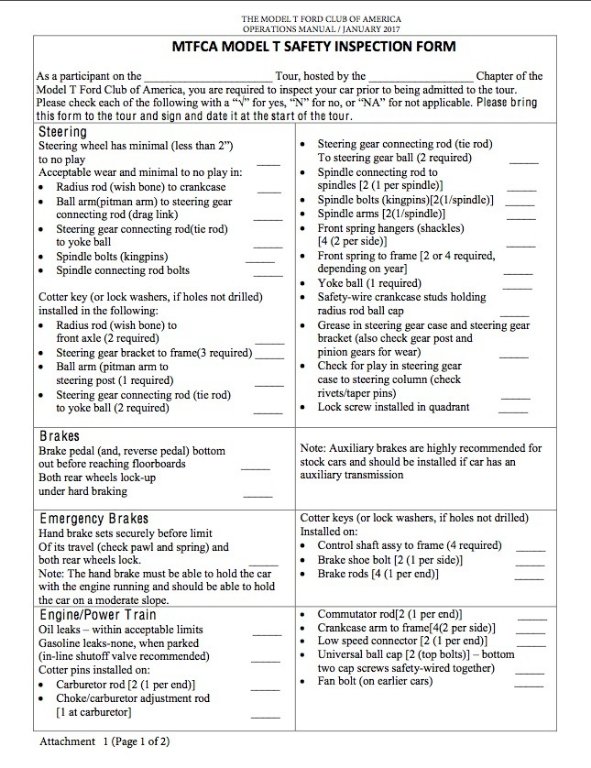

Hi Edwin, welcome to the affliction! I also flew a Piper and presently also have a '27. I don't know your T's condition, but I would recommend that you download the safety inspection sheet(s) from this site and be sure that your car is up to safety standards before you drive it much.

...I would recommend that you download the safety inspection sheet(s) from this site and be sure that your car is up to to safety standards before you drive it much.
Excellent idea. Both national clubs have them.
