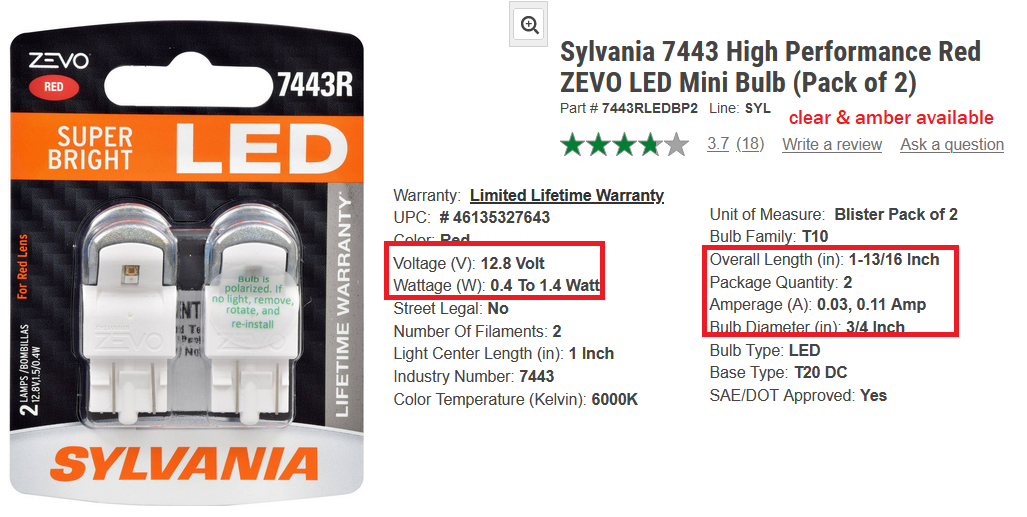

I found an old ad on the internet for one that Lang's sold. It appears to have 3 wires similar to what a trailer might use. After looking at Internet search results for Model T oil Lamp conversions there were a variety of solution. There are many 2 & 3 wire sockets available that could similar to what you have. So do does yours have 2 or 3 wires and is it set up for brake, turn and running light or what ? The number of wires would be tied to how they were connected to the rest of the car - like
A picture will help as well. By the way converting an oil lamp use to LED's would also be a possibility. I'll be glad to see if I can find a solution for both. --
If just 2 wire these would work and there are many more styles
