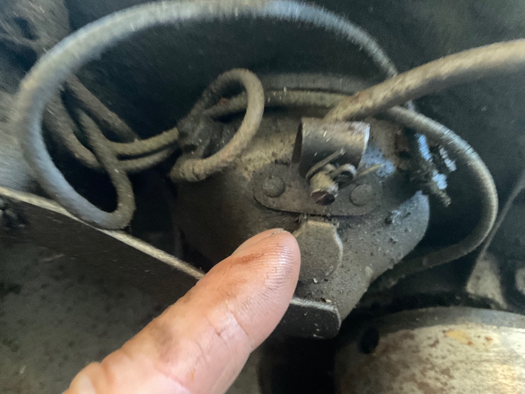

I would value anyone’s insight on a good place to go to find detailed information with good pictures and or video regarding engine timing, and timer maintenance….I am afraid to even touch it at this point…lol….As I alluded to, this is going to be the first of many questions…. What lubricant should I use in the timer? I think I have found the place where it is to be added, pictures to follow….many thanks in advance!

Lube with engine oil. Take timer off and wipe out the gunk from time to time, now would be good looking at the picture.

Removing and replacing the timer cover will not affect the initial timing setting. One thing to be careful of is the wiring. If the insulation is brittle or chaffed, it may short to ground when the engine is running. Pay attention to how the wires are routed, and try to get them back exactly where they were so that they will not rub or get fouled in the fan belt. Clean the area around the timer before taking anything loose to prevent dirt from getting inside it.

As far as your Timer lubrication is concerned you have a roller style timer that needs a light grade oil and cleaning ever so often. It looks like the timer wires are in good shape and haven’t lost any insulation.
Loosen the bolt that holds the timer flat spring and remove and clean out the case, replace it and squirt in some light grade oil in the fill cap. Some use light grease.

Edwin if you do decide to clean the commutator you can also check the roller attached to the cam without removing it. The roller can have a lot of play on the pin shaft causing some issues. You will note that it should be spring loaded as to put pressure on the commutator contacts however the roller itself can be wallowed out oversized on the pin that can cause ignition issues.

From the photo I can't tell what kind of timer you have. When you remove the cover take a close look at the brush and see what condition it is in (post a photo.) Steve Jelf has an excellent discussion of timing at <https://dauntlessgeezer.com/DG97.html> that you might find interesting. If you find it necessary to replace your timer it will allow you to check whether the new one needs any adjustment or whether the old one is properly set for that matter.

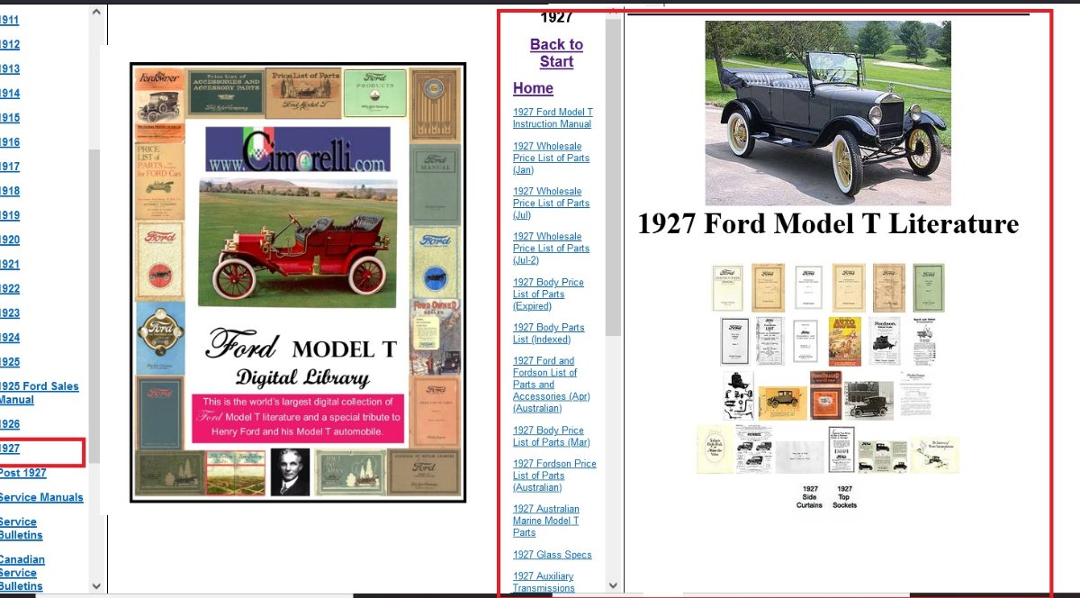

Lots of Downloadable / Printable Documentation on Cimorelli's Site
http://www.cimorelli.com/mtdl/default.htm or http://www.cimorelli.com/mtdl/1927/default.htm
Click on side menu or manual image

The timer that flyingpiper has pictured in his first comment is a original style roller timer that required light oil lubrication. The oil filler flip cap on top of it identifies it as one with his finger raising the cap.
