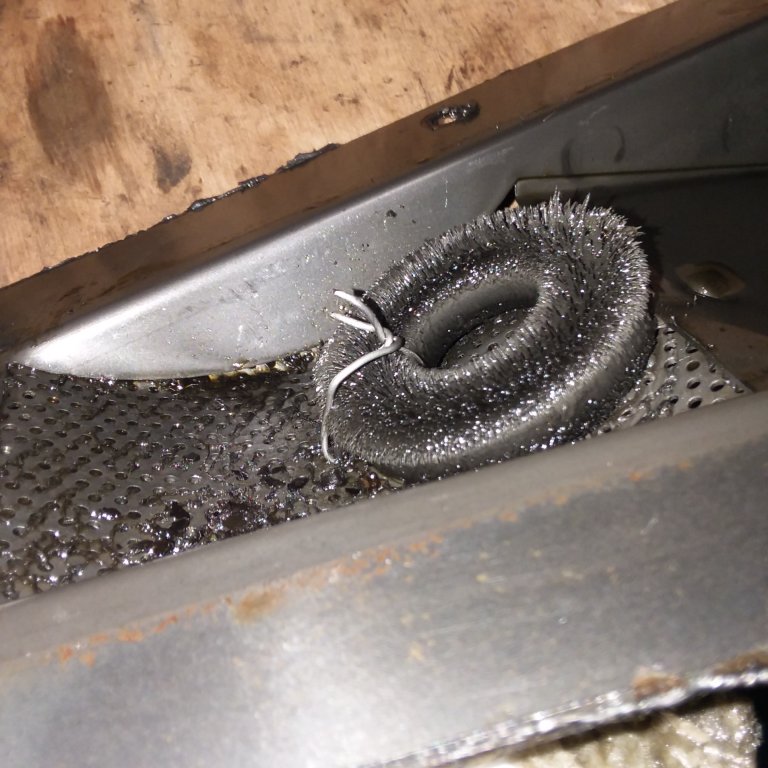

The pic is of the 1rst screen magnet cleaning last week.
Maybe the little fuzzy's attacked my mag post too.... we'll see shortly.

These fuzzies are iron.(magnetic) The fuzzies on the mag post would be from the bands
Posts: 7982
Re: MAG FAIL
Post by TXGOAT2 » Sat Jul 30, 2022 2:53 pm
That's a lot of metal. I'd want to know where that is coming from.

T’s are fairly simple. Check the simple things first which is usually a mag post not getting good contact, loose mag connection wire at the coil box or the ignition switch. Do a quick temporary cleaning of the ignition switch by turning the key back and forth several times before you start it again and then turn to mag after it’s started on battery. Give it a try.
The metallic fuzzies may be from the magnet hold down clamp running to close to the field coils.

That’s a lot of metal on that transmission screen magnet. Drain the engine oil looking for metal. I would then remove the starter drive, starter, and the transmission inspection cover and screen. I would shine a bright shop light into the transmission as someone slowly turns over the engine with the hand crank. You are looking for the source of the metal and any thing else amiss in the transmission and the condition of the field coil. Your used field coil, old coil wrapping may have failed and some of that metal may have shorted out some of the coils. See if you can find where the metal is coming from, it could be from something like a loose magnet pole striking the field coil or a brass plated steel band lining rivet scratching a transmission drum. You may not find the problem but keep a eye on the oil and transmission screen for more metal if you choose to run you T on battery to keep driving it.
