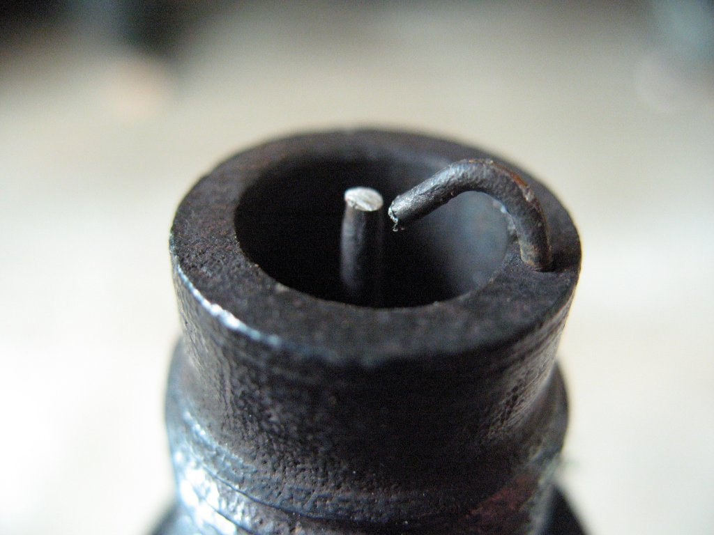

I tried out a NOS set of Rentz Spark Plugs after running new Champion X’s for a long time. They have a longer electrode than the Champions which I assume makes them a hotter plug, so I set the gap a bit bigger on them, between .030 and .035 for the Rentz. The champions I have set at a snug .025
Upon driving I had to give the ignition more advance than before, at a cruise of 25-30mph I advance the spark all the way now, where I was previously setting it at 3/4 advance. Now at 3/4 advance I get an occasional stutter like I have too much retard.
Town driving at around 10mph I have it set at 1/2 advance where it was 1/4 advance before. Again anything less produces a stutter.
The engine doesn’t miss a beat at idle and free-revving is smooth and causes no stutter.
Sound normal? Maybe my gap is too big or too small…

I would go back to a smaller gap. The longer electrode would not give a hotter spark, but the plug tip would likely run hotter. Be sure the plug wires are not touching anything or positioned near anything. The Champion plug with the sharp edged electrodes would fire at a lower voltage than the Rentz plug with the rounded electrodes. The Rentz plug would probably hold an adjustment longer. Try the Rentz plugs at .025 to .027.

Some plugs with rounded electrodes tested poor to bad. I flattened the ends of the electrodes with a miniature grinder and most tested OK. I haven't tried them in a car yet.

Restoring the original electrode profiles can make a difference. The ideal electrode would probably be a needle point, but that's impractical for several reasons. The plug you pictured has very worn electrodes. Setting the gap would help that plug, but restoring the electrode profile as shown, and setting the gap would probably get it close to as-new performance.
