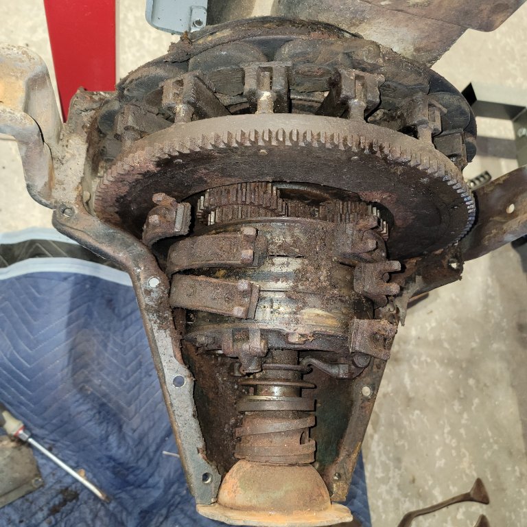

How do you remove the back side of the ball cap? I am trying to get the transmission off a 19. The cap looks very rusted.

I'm not conveying what the problem is. See Pic and you will see the ball cap on the end of the shaft. I can not get that off. The oil pan is gone now. Its on older picture.

It's rusted on - dead blow hammer should do it otherwise generous amount of penetrant !
Posts: 6817
Re: WTB 4th main bearing cup
Post by Scott_Conger » Sat Dec 10, 2022 8:00 pm
That cap has a babbit bearing and it will need to be rebabbited and bored to size. The clutch spring should almost certainly be replaced, too.
Given that, I see no downside to simply putting a torch on it and heating it until the babbit yields from the output shaft
Afterwards, if the output shaft is in good enough condition to save (very likely), then any babbit that is stuck to it can be cleaned off during its restoration and resurfacing
