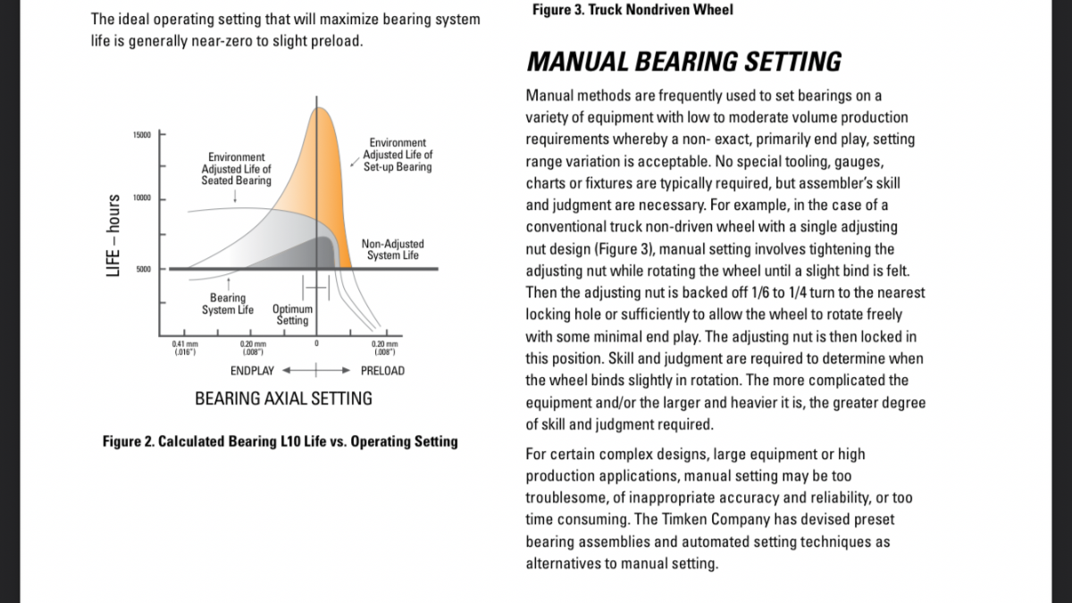

Here is a shot of (and link to) the Manual Setting section of the Timken catalog where clearances are discussed. Not much different than the Ford procedure
https://www.timken.com/wp-content/uploa ... hure-1.pdf

I have a wooden wedge which I drive between the spindle body and the axle yoke to take out any wear in the spindle bushes when feeling for play in the bearings. Then I set the bearings with some play before tightening the spindle nut. This will take out any looseness in the threads. You need to be able to feel just a tad of play when rocking the wheel on the hub. It is better to have a little play than to be a little tight. There is no need for any preload on model T bearings.
