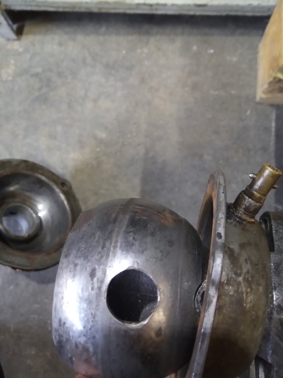

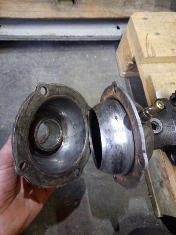

I have now discovered another problem. What's the best thing to do when the ball is loose at the driveshaft? Tried to put in a disc from Snyders. But then it gets too tight.
Greetings from switzerland

Since adding a ball "shim" makes for too tight, you dont have a problem of "excessive" wear or loosness.

The shims as they are made a too wide. Trim a little strip off the side of the shim towards the drive shaft. If there is still a gap between the flange and the ball cap a paper gasket can be installed between the two so the bolts can be tightened without causing the ball to bind up. I've done it this way several times and was able to eliminate all play in the ball connection. Getting the fit tight again here will often eliminate an annoying clunk when shifting into high and can also cure noises as the car comes to a stop with the transmission brake.
Agreed!

I would not worry about it. It is just a housing for the universal joint. Most important is to make sure the 4 th main is straight on the crankshaft and pan. Is it still loose when all four bolts are tight or just now in the picture. When you have it all installed it may not be loose anymore.

The ball cap is widened quite a bit on the back.
It would be best if I could replace these as I have now disassembled the whole driveshaft and rear axle.
But I can't find a replacement for a 1926 from any supplier. Is there really no replacement for the ball cap?
Greeting

5&11 o clock 2.382"
The worn area can be seen in the pictures. 11 to 1 o clock is also porous. That was below. Maybe rust due to water / condensation in the gearbox?
Can I risk it with this spool?
greetings from Switzerland

Post by Jerry VanOoteghem » Sat Aug 20, 2022 1:06 pm
In all likelihood, if you positioned it in the best possible way, as described above, you would probably be okay. I don't imagine the rear end was needing a rebuild solely because of this issue. I'm sure many of us, with cars restored long ago and lots of miles on them now, have this same situation and don't even know it. Still, I would at least attempt to find a better one first.

Post by speedytinc » Sat Aug 20, 2022 1:25 pm
Agreed. A quick hone will confirm the best of the bearing wall. I think its usable. Look @ the worn spot & make sure there is no metal flaking away. If there is, I wouldnt use it for risk of the metal doing damage to your bearing & new inner race.

Post by speedytinc » Sat Aug 20, 2022 2:00 pm
JTT3 wrote:
Sat Aug 20, 2022 1:35 pm
Jerry & John if he ordered the Funproject/ Birdhaven type wouldn’t that eliminate his concern and issue? Just a thought if he is going to have to have it shipped anyway. I personally think it is a much better way to go. IMHO. Best John
I stay with original parts.
I understand that F/P type conversions work very well. I would consider that a good option.

Post by Craig Leach » Sat Aug 20, 2022 2:19 pm
I'm with John T,
I picked up a modern bearing pinion for my Ruckstell while I had it in hand I machined a spool for the modern bearings using a spool that was in the same shape as yours is ( that was the reason I purchased the new style one) I'm not putting down the Hyatt pinion bearing Quite the opposite I have two complete set aside for the future. But sometimes good spools are hard to find when you need one right away.

Post by Vonau » Sat Aug 20, 2022 3:16 pm
Thanks for the feedback
I realize that a modern warehouse would be the easiest way.
Although we have many classic cars in Switzerland, Model Ts are very rare. To be honest, I've never seen a mobile Tin Lizzy live and I'm probably crazy that I bought one myself.
When I disassembled the rear axle, I was so fascinated by the old technology that I want to keep it. I think maybe someone will come after me and be fascinated by it again.
Finding a good spool here from Switzerland is very difficult. I recently bought one off ebay. The inner surfaces looked very good, but measuring them showed much greater wear than my spool.
I am very grateful for all the help here in the forum.

Post by Jerry VanOoteghem » Sat Aug 20, 2022 4:59 pm
I would contact Lang's and ask what good, used spool they might have in their inventory.
