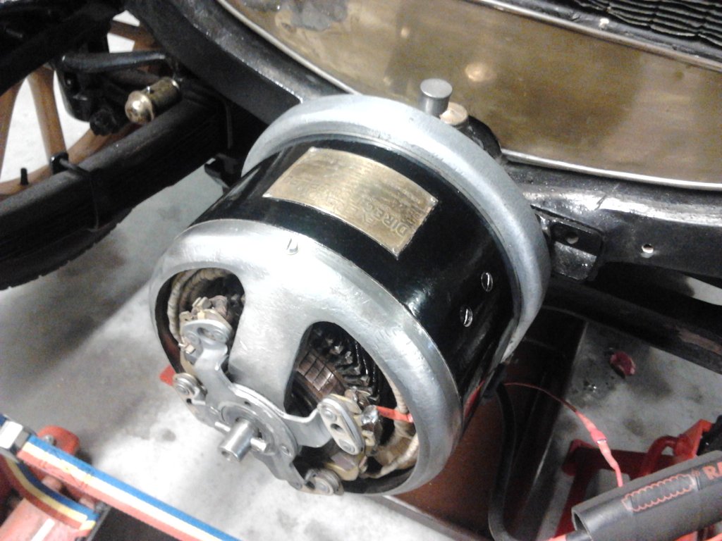

In the past I have seen Everday starters that were made for Model T cars. One was spring loaded and an other was electric starter and generator
in one.
Just look out for one and make it work again.
An other solution is change the flywheel, the hoghead and build a starter in it. Do not forget to build in the reinforments in the oilpan corners.
Good luck.
Andre

Good question. I'm thinking an early 1950's Ford generator might be up to the task if it had a good battery and heavier wiring to supply it. It could be set up as a starter-generator with a toothed belt drive or a modern flat-type belt and tensioner. Duty cycle would be limited. One of those big Delco generators like were used on Mack trucks would no doubt spin the T motor. They're big, though. It would be possible to offset the weight by using it as an auxilliary power source to boost available HP for a limited time. You'd need a substantial battery and some relays, but you'd have a self starter, a high amp generator, and a hybrid T with some reserve power for hills and other short period transient HP demands. Some regenerative braking would be available. Modifications to the engine and car, if any, would be minimal.

I think it was Ron that posted that a T starter was 12 ftlbs of torque - but that's divided by the gearing on the flywheel - if hand cranking requires 10 lbs - that stock starter has it very easy! I'm really on the fence about which engine to put in this project. I have a 17 and a 27 to choose from to put in this future brass car. The sticking point is "I don't want to have to crank it".

Yes, Ron did post that...so did Frank, just 2 posts above, in the torque breakdown/spec sheet he posted, so no need to wonder or try to remember.
Twelve ft/lb is a good stall test of a rebuilt starter and is pretty much the gold standard for repairs, and is what I and I'm sure others, used when I rebuilt them a number of years ago. Seems like a lifetime ago, looking back...

I may regret it someday but I have left the stock Armstrong starter on my 1915. For the past couple of years, off and on, I had a hard starting problem and had to crank a lot for a cold start. Recently I started just jacking a rear wheel off the floor and starting in neutral as a regular part of the starting procedure. I usually get a start with two choke pulls and a third pull with the switch on BAT. A couple of times I even got a free start when I flipped the switch. Of course, starting on battery you don't have to pull fast. Even a slow pull should work. If your cousin can manage three pulls, maybe that can get him by while he searches for one of those rare add-on starters.
