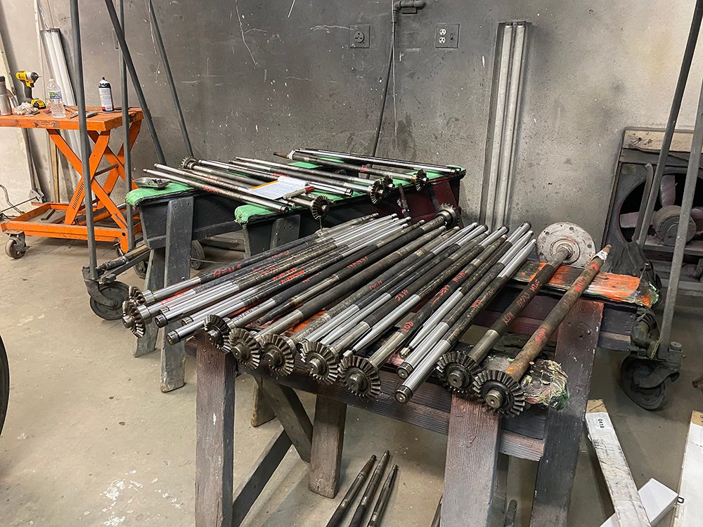

Recently I've helped a number of our club's new Model T owners with assessing the mechanical condition of their purchases. One common problem we found were rear axles that needed replacement - most damaged by the axle nut not being tight enough. Cracks radiating from the key slot, worn slots, corrosion / damage on the taper, etc., were the most common reasons.
You want the rear axle nuts really tight - I torque them to the max setting on my torque wrench (75 Ft-lbs) then tighten the castle nut to the next slot using a breaker bar and socket. You'd think there was no way that wheel could ever loosen up but drive it a bit and it will. Put a wrench on it again and I guarantee the nut will move a lot easier than you would expect. Tighten it again to the next slot in the nut. Checking it periodically will save your axles. Be sure you put the wheel on the axle without lube - in fact, clean the mating surfaces with a solvent before assembly.
I've attached a photo taken at a friends business where he was getting ready to repair some Model T rear ends in an assembly-line manner. Five of those sets of axles come from cars I was helping on.

I rarely have a T come here for repair that has the rear hubs properly tight. Not coincidentally, most rear ends I take apart do not have axles I would use for something I would build for myself or put my name on for someone else. It is imperative you keep these things tight. 75lbs/ft at least. If you can’t get that kind of torque then the threads on the axles, nuts, or both have failed. Your safety is at stake here. If you don’t have to use a hub puller to get the wheels off, you are inviting trouble. It’s that simple. New axles are a hundred bucks and change, and they are nice products. They can be had with a little extra length to compensate for hubs worn by loose nuts, and also give a little more room for installation of accessory brakes, also a good idea.

A little more to the story.... our club has been having "T-Parties" where we gather at a members house to do some work on their car and "educate" them. Like I said, we have a number of guys brand new to Model T's. I went to demonstrate a hub puller on a newly-purchased roadster and the wheel came off while I was turning the puller on. The key slot was so wallowed out you could flick the key out with your finger. Rx - new axles. Makes me wonder if a pre-purchase inspection shouldn't involve jacking the rear wheels up and pulling the wheels? Of course, that only tells you about the axles and outer axle seals...nothing about the thrust washers, hyatts, etc.

I just got back from a great time at the Michigan Jamboree. Prior to going I checked my axle nuts again and they were good this time and didn't require any additional tightening. This was after 600 miles on the MTFCI national tour. Nonetheless, I'll check them at least once a year just to be safe.
I started this thread because I was seeing axle damage on all the cars I worked on and was told by people I respect how this was a common problem on the cars they see. I am new to the hobby but have benefited from the knowledge and help of more experienced T'ers and felt it important to pass such knowledge on. There is so much that is unique to the Model T that we must share it with those new to the hobby and hope they will do the same. It also doesn't hurt to remind long-time T owners of such problems. This forum is a great example of how that sharing of knowledge takes place and I'm glad to do my part.
