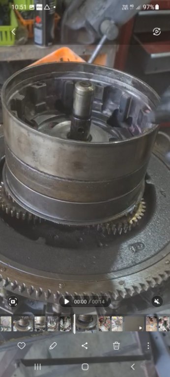

I have just reassembled the engine and gearbox about 5 months ago. I have just installed the engine into the car and tried hand cranking to make sure everything is free. If I put the handbreak on I cannot crank it. If I put it in the middle and jack the wheels off the floor I can crank it but the wheels turn. Have I put something together incorrectly or does it need to be run and go through the gears to free everything up? If I pull the handbreak on the forks are free in the box.
Here is a video.
https://youtube.com/shorts/dg7Mt1BbWFA?feature=share

In your video, the transmission is shown in high gear, not neutral.

No matter where I put it the wheels spin or with handbreak on the engine won't turn over.

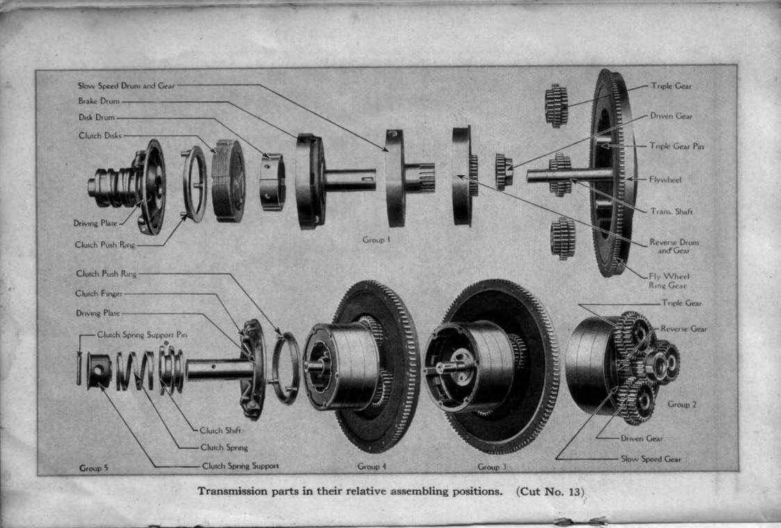

Before you start making adjustments -
When installing the hogshead, you have to make sure that the clutch fork (clutch yoke) is seated properly in the clutch shift.
The clutch shift is on the driving plate shaft, fore of the clutch spring and clutch spring support and pin.
The clutch shift has two grooves. You need to make sure the clutch fork is seated in the rear groove.
When the clutch pedal is pushed, the clutch fork pushes the clutch shift rearward which, in turn, pushes the clutch spring rearward.
Once you have determined that the clutch fork is sitting correctly in the clutch shift, then make adjustments to the clutch linkeage to get your "free neutral."

Those are brake drums.
Refer to the diagram I posted. Click on it to enlarge.

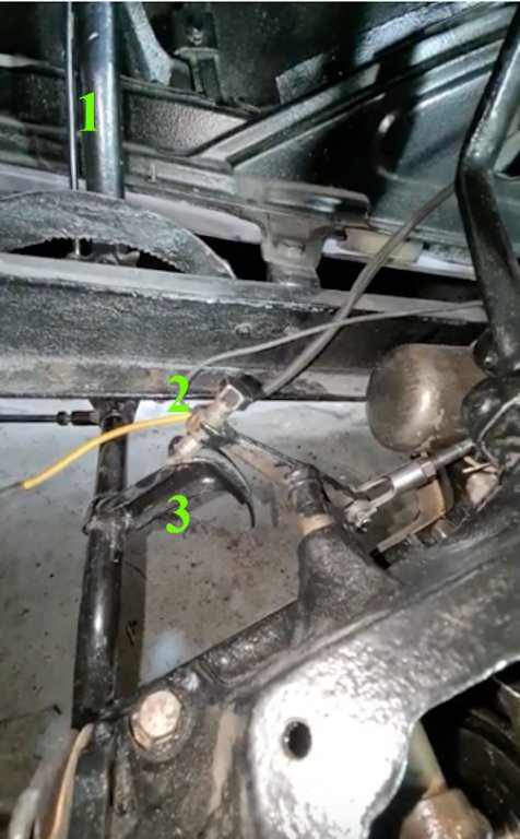

I have read everything I can and watched every video I can find to do with the gearbox and I have done everything correct from what I can remember. I have just adjusted everything again with no difference. Before I start it tomorrow (first time ever) I thought I would do a quick video to see if anyone could pick up on anything incorrect.
https://youtu.be/IKl56-gKFvI

Linkage issue. See the manual. When the e brake lever is vertical, the cam should have pulled the clutch to neutral, disengaged. It does not. You are still in hi gear, no neutral. 10 degrees or so past vertical the cam engages & you have a neutral clutch. Very last of the video.

Tighten that bolt a few turns, three or four, so the bolt will touch the cam before the emergency brake lever is vertical. This is only an estimate on the amount of turns on that bolt since physically being there with you may result in one turn or less. You should have a nut on that bolt to tighten your adjustment, without, the bolt will loosen and present you again with your problem.

With the brake lever (1) straight up or farther back, the speed lever (3) should be raising the clutch lever (2) for neutral. With the clutch lever down you are in high gear.
I doubt that adjusting the screw will fix this. I appears to me that the angle between your brake lever and your speed lever is about double what it should be.

Looking past the brake light switch here you can see that with the brake lever straight up the speed lever has raised the clutch lever for neutral. Comparing the two pictures, I may have been mistaken about the angle of your speed lever (cam). They appear very similar. Maybe a screw adjustment is all you need.

In Steve's picture, he has the bolt inserted the opposite way, which is threaded in from the bottom, it's just the same as my car. The head of the bolt has more mass to contact cam section, and in turn to take drivetrain out of direct drive. Locknut is threaded from the top and then secured to hold adjustment.

Thank you so much guys. What can cause this and what's the fix? Should I just cut the cam off and weld it back on? If someone has a video with the cover off the hogshead and showing the selector being moved that would be amazing.besides mine I have never seen one in the wild and when I got mine there were a few "alterations" done to it which has caused me a few headaches.

Looking at a 1915 and a 1923, with the brake handle vertical the speed lever leans forward at an angle of 35º on both cars. Before you start changing anything, check your angle and see if it needs to be changed. I don't know if it's the same for all years, but on my cars the speed lever is pinned, not welded to the shaft. If your angle is wrong, and especially if the lever is welded, it's probably a home made bungle. Or, as Scott suggests, maybe the brake handle is pinned at the wrong angle. The dip in the controller shaft (under the drive shaft) should be exactly vertical when the brake lever is vertical.

Really quick update. After 40 years the model t started and ran. It was running rough as one of the coils is average and one of my new spark plug terminal has broken away and the entire rod comes out or the plug so replaced it with an old plug :(
After running it and pressing every peddle possible the disks are still stuck.
I'll pull ithe engine out this weekend.
Question: do i need to remove the pan to remove the gearbox assembly? Last time i had everything on the engine stand.
While the engine is out ill check and fix the brake handle.

You guys are amazing! So what's that old saying? It's not stupid if it works :lol: it's still a little tight but the rear wheels are on the floor and I can now crank it by hand. Strange what ideas you come up with at 3am.
I ha e looked at the handle and it seems to me that the handle and the arms under the car are inline.
I have made a few adjusents. Does it look better?
Posts: 8047
Re: Wheels turn when cranking.
Post by TXGOAT2 » Thu Sep 01, 2022 7:24 am
That looks better, but the cam that the adjustment bolt rides on is too far forward when the lever is straight up. It looks like the clutch is not being fully released when the lever is straight up.

So the only way to fix that would be to pull the pin from the cam and move it and drill a new hole?
Posts: 8047
Post by TXGOAT2 » Thu Sep 01, 2022 7:45 am
That's what it looks like from here. On my '26-27 car, the cam lever appears to be about 20 degrees forward of vertical when the hand lever is straight up. The adjustment bolt contacts the cam face just a little past the sharply-curved part. Yours seems to be contacting the sharply-curved part. I don't think that is correct. I don't have a way to post a picture, or I would.

Ok, so the selector is in the correct spot for low/neutral? If so should the bolt be on the highest part of the cam?
Posts: 8047
Post by TXGOAT2 » Thu Sep 01, 2022 8:26 am
With the hand lever straight up, the bolt should be on the highest part of the cam, just past the sharply curved portion of the cam. On my car, that has the adjustment bolt pointing straight toward the "stem" of the mushroom-shaped cam.

Your adjusting bolt (clutch lever screw) is turned in almost as far as it will go. That leaves no space for a locking nut and may be overkill. Back it off as far as you can without losing your neutral. That may change its angle to better coincide with the high part of the speed lever. It might also help if you widen the business end of the adjusting screw by turning it around with the head down. If it's a modern bolt, grind off the raised markings. A locking nut can go on top of the clutch lever (See my 8:44 AM 8-30-22 photo above).
