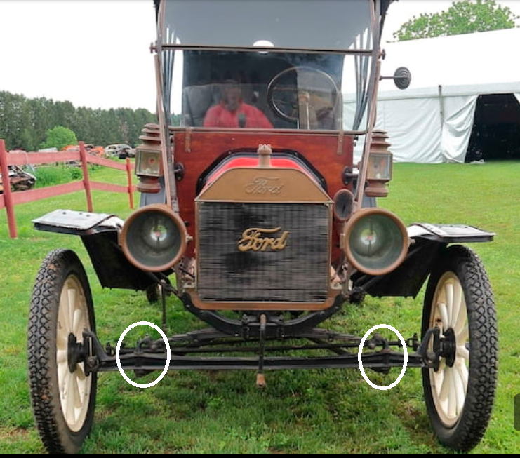

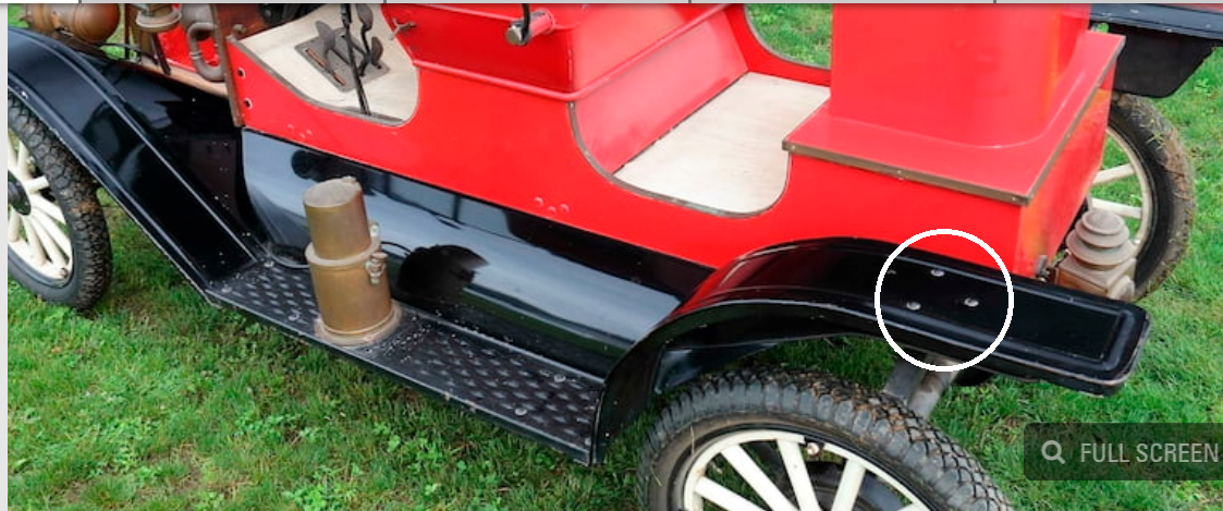

Lot S93 is listed as a 1910 Model T Ford. It its a roadster style body with a mother in law seat. I do not see any actual 1910 parts. It has a later chassis and what looks like a replacmen t reproduction body. Go take a look. Elmer had at one time a "1909" that had a later engine. At that time he would not ley me take a close look at the chassis.

That "1910" Model T is just a fantasy. Here's a link for those who are interested:

I beleive that this vehicle was built up from the odd older vehicle Elmer called a 1909. That vehicle had a buggy seat. AT that time, Elmer did not let me examine the vehicle. There was a rope in front of the cars. This was about 30 years ago.

One of the worse looking fake 1909 bodies I have ever seen. I can actually like ones that look sort of right. I always love to see Rich Eagle's 1909 in tour pictures! His has a perfect look, the stance, top, everything from twenty feet looks right. And there have been several others I have known over the years that I love to see on tours! They look great in photos, and going down the road. Even when I know the chassis is 1920s? I like the look and I like to see them.
This abomination looks like a Shriner's clown car on steroids!
