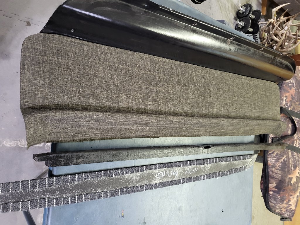

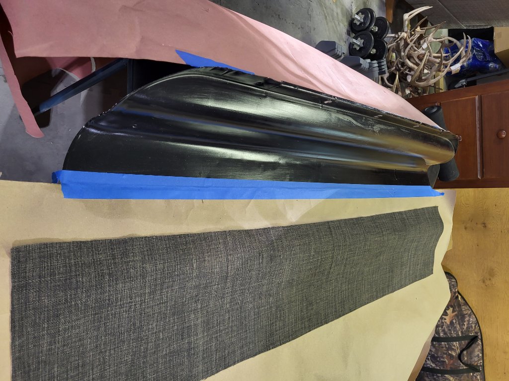

We did the "first" upholstery work on the coupe today! We used 3M super 77 adhesive to glue the fabric to the back side of the tray. Applied the adhesive to both sides (steel and fabric).
The first two pics show the material that the kit has to cover the tray. The third one shows the area taped off getting ready to apply the adhesive, and the last one shows the finish product.
The next step is to glue the hard backed piece, shown in the first and second photos, into the bottom of the tray.
Sorry for the odd orientation of the photos. I don't know why it won't allow them to be oriented vertically.

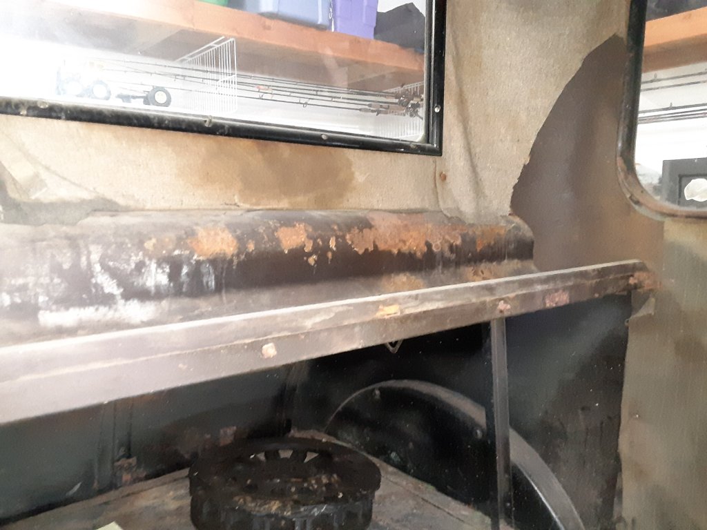

Here is a pic of the tray in the coupe before we started the restoration. I should have included it in the previous post.

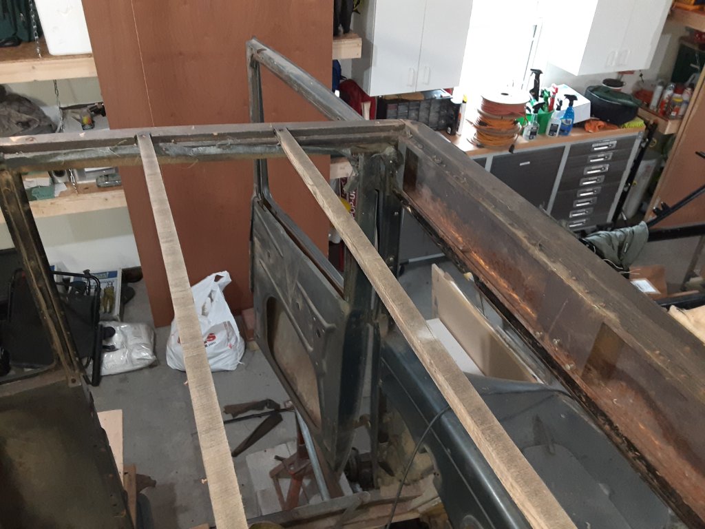

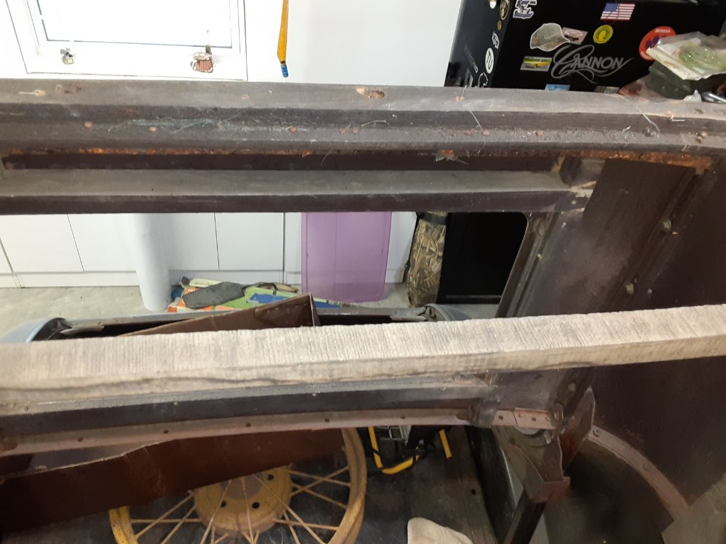

Just to clarify, I am leaving the existing wood frame in place and installing the headliner. I will install the top material after the headliner and the interior upholstery are in place. I understand some remove the wood frame and install the headliner on to it. My wood is in good shape, but I think the individual sections that make up the frame would come apart if it was removed.
The only part of the frame that will need repair is the end of one section that is shown in the second photo. I will cut out a small piece and replace it.
I think installing the headliner is going to be challenge!! Looking forward to some suggestions.

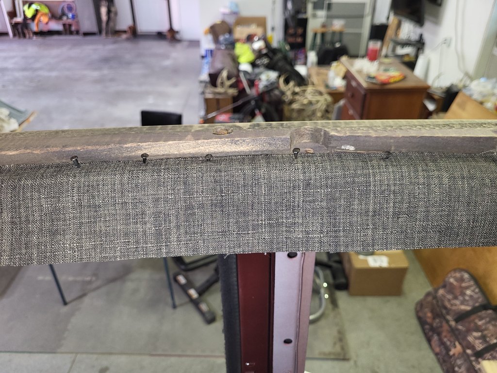

Today, we installed the "first" piece of upholstery in the body!!! As a starter, it was installed just over the doors. We tacked the top of the piece on to the grove in the top of the wood frame. We used spray glue to attach the material to the side and "bottom edge" of the frame and on to the metal below it. It went well.
The instructions showed tacks being used to attach the material to the bottom edge of the frame. We tried this, but it was hard to get the tacks into the corner between the bottom edge and metal below it.
