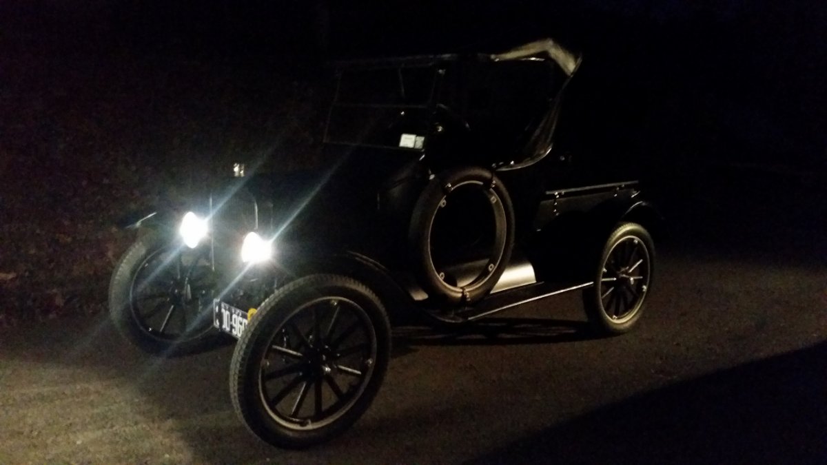

My darling bride Linda and I came home with the Coupe after dark the other night and she admitted that we could see much better. I will be putting them in my 28 Huckster too.

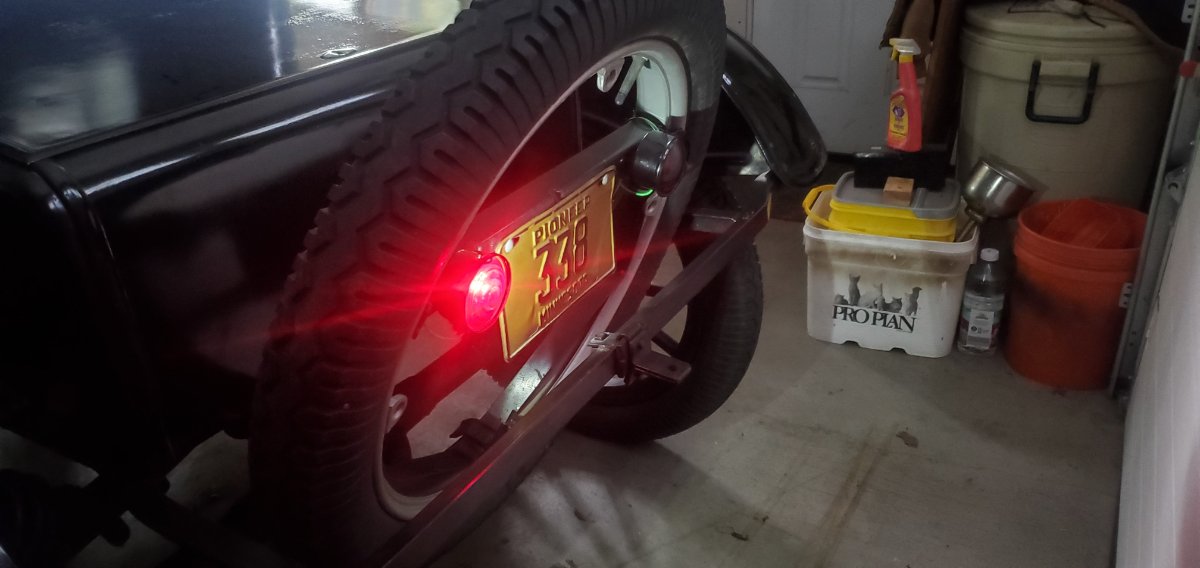

The tailight is much better also.

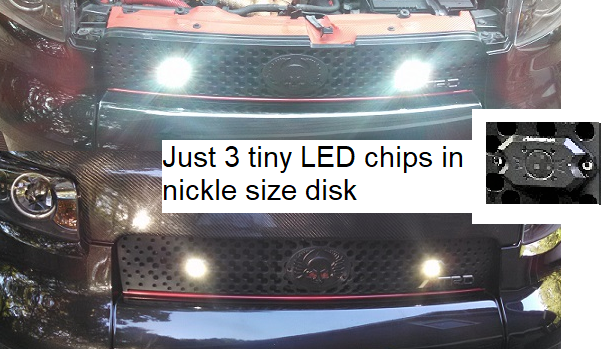

Illuminating the glass lens is not an indication of how much better the road is illuminated. I put led daytime running lights on my daily driver that were so bright they'd hurt your eyes, so I put a smoke film over them. Either way they have little effect in lighting the road ahead for more than 5 feetTim Rogers wrote: ↑Tue Oct 25, 2022 2:23 pmThose LEDs look pretty good! I guess some folks struggle with the incandescent bulbs, but here's my 6 volt OEMs- nice, brilliant white lights!...

Steve drove the car to our Model T meeting on the 19th. The light output is good and the headlights do focus pretty well. It looks good oncoming and there is plenty of light to see where you are going, way more then your standard lights at much less amperage. He also has rear tail/brake led lights. Better vision and visibility is a big win for driving at night.
