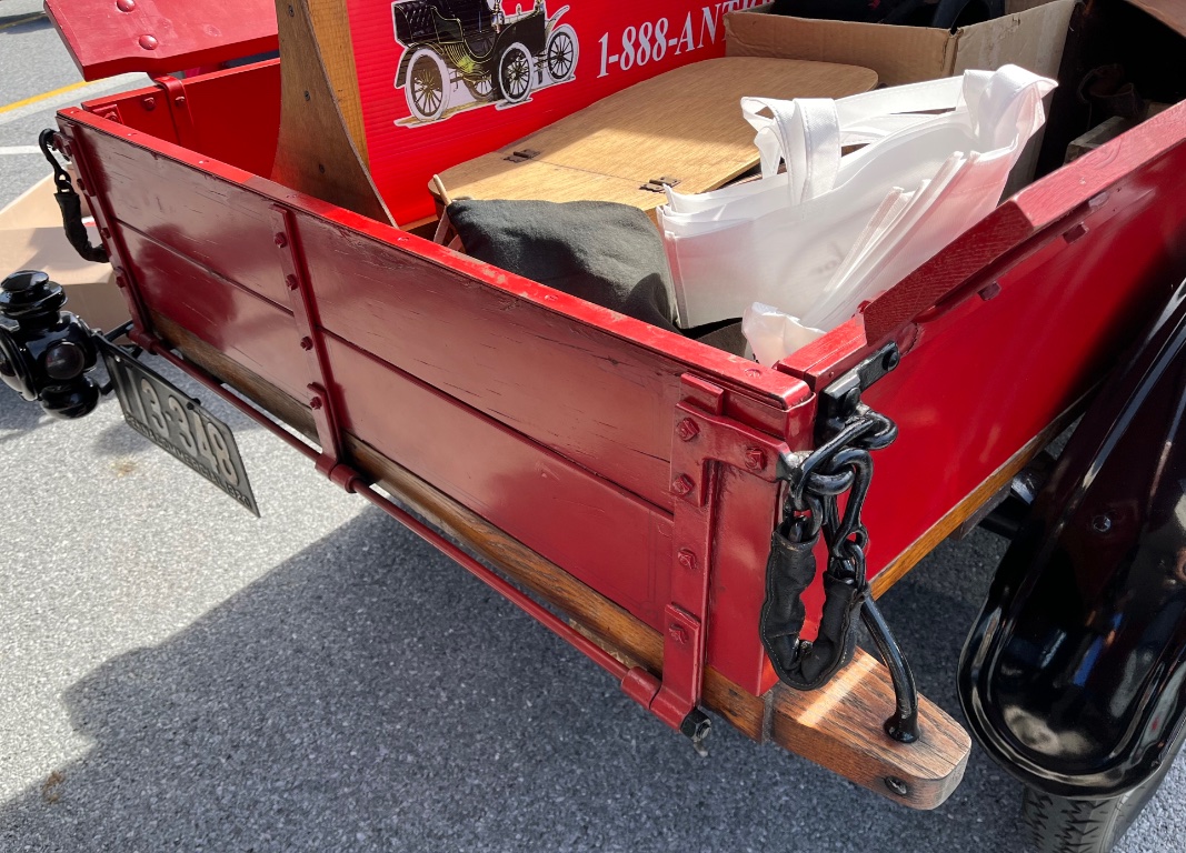

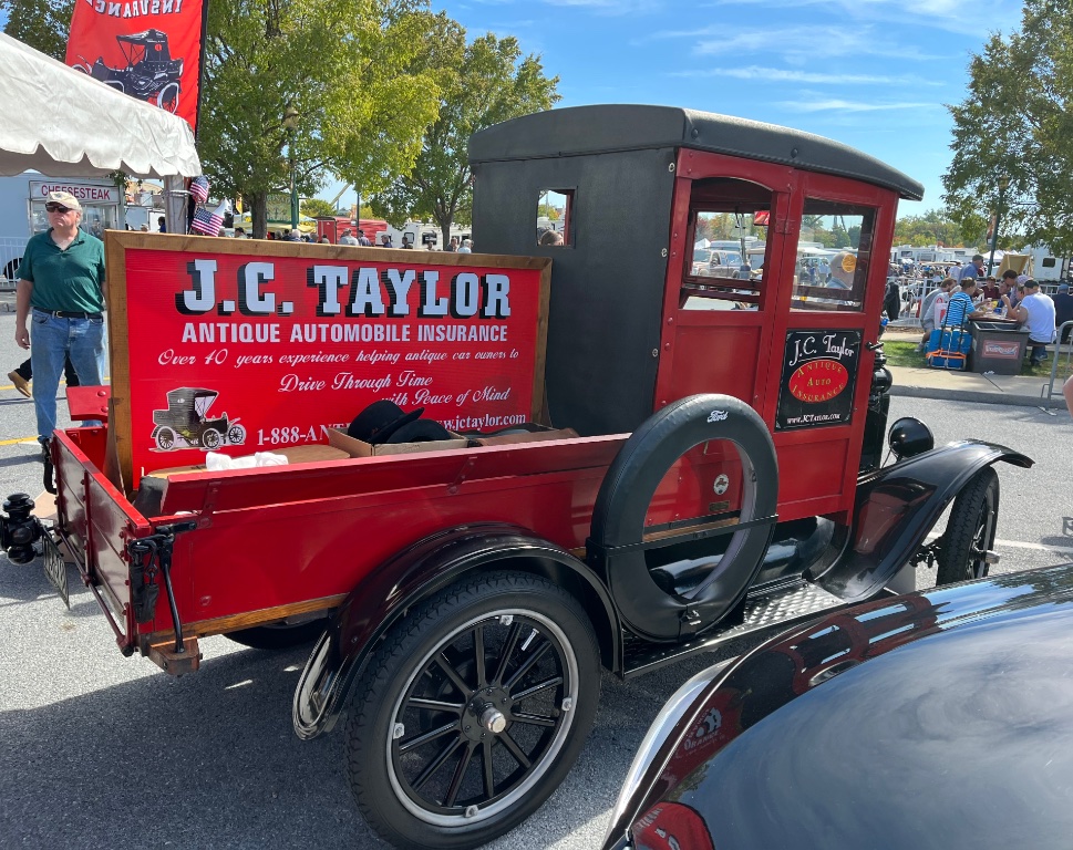

I stopped by the JC Taylor tent every day. Due to the rain they didn’t bring it out until today.
It was a challenge to get some good pictures from the angles that you asked for because of how it was parked but did the best I could.

More pictures. Hope these are useful!
- Posts: 6946
Re: J C Taylor little red truck.
Excellent work Ed. Many thanks. Your photos show more details for me to work with. The ironwork to hinge and latch the tailgate is clear. I can work the overall dimensions from the square on photos. Interesting way to mount the door hinges, totally on the outside of the body. If you see any of the windscreen hinges like those, it looks like I need two pairs. You have me excited.
