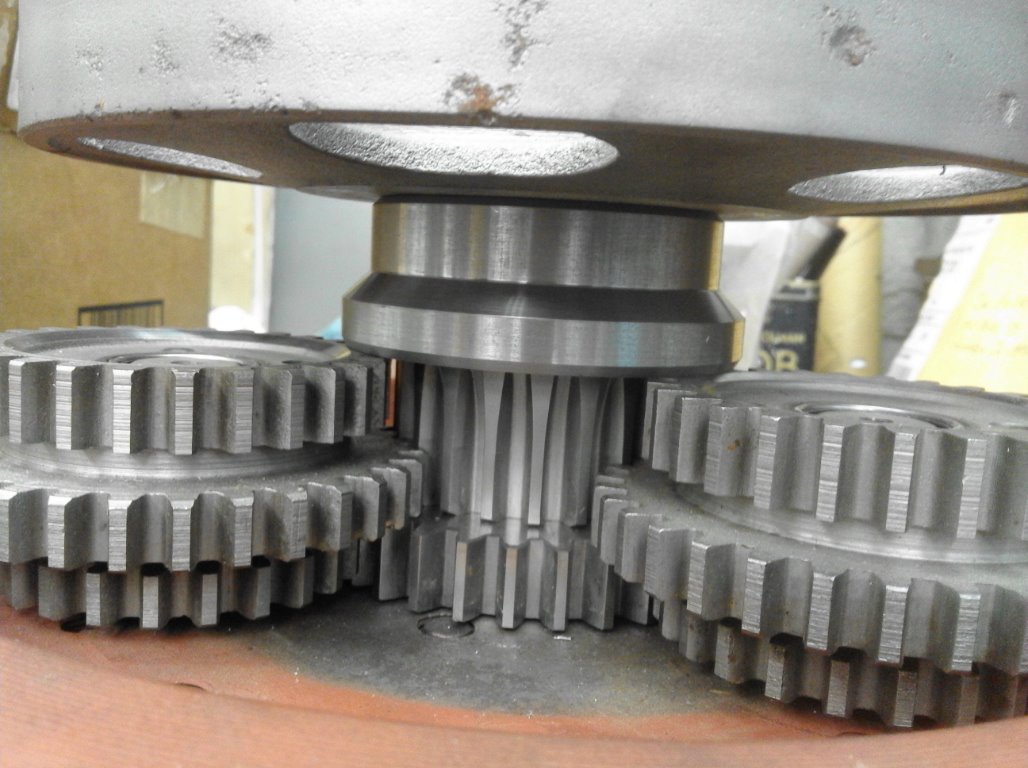

Dan McEachern
- Posts: 1512
- First Name: DAN
- Last Name: MCEACHERN
- Location: ALAMEDA,CA,USA
Re: Low speed gear
Here is what Mike is referring to.
- Posts: 5276
Re: Low speed gear
Thanks Dan M. for the pictures. Its simpler than I imagined.
Art M
- Posts: 990
- First Name: Art
- Last Name: Mirtes
- Location: Huron, Ohio
Re: Low speed gear
I am not sure, but this arrangement might result in a reverse gear. I wonder what the gear ratio is
Art Mirtes
