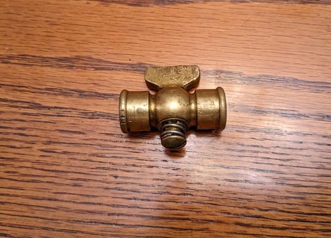

I do have an inline shutoff valve that came with the car (second picture) and it threads onto the Holley elbow. The fuel line pack nut sold by the vendors also threads on, so it the shutoff valve and Holley elbow have the same thread as the fuel line pack nut. What I need to find is a male union with the "pack nut" thread so that I can attach the fuel line pack nut to the union, the union to the inline valve, and then the inline valve to the Holley elbow.
Does anyone know what the thread type is on the pack nuts so that I can try to find a male union for it? It does not appear to be a pipe thread, and the last picture shows the Lang's pack nut attaching to a 90 degree elbow with piece that goes over the fuel line to make the seal. I suspect whatever union I find will need to use those as well. Any help/suggestions would be appreciated.

Does the tap screw onto the carburetor elbow? Does it screw on in the same way if you turn it around? If the answer is yes then you need a double male ended piece we call a nipple in Australia. Screw one end of the nipple into the tap, the other should take the standard T packnut, with its felt/neoprene seal.

It has been my experience that any valve used with a 1/4" fuel line yields insufficient fuel flow. I used to like 5/16" fuel lines. Now 5/16" fittings are hard to find. I would suggest you use what ever combination of fittings you can to make it work. What is the thread on the valve shown? I believe it is a valve for indoor residential gas lighting. I used one on my car, too with a variety of fittings, ending with 5/16" to 1/4" connector and then 1/4" pipe to the carburetor. Does the center-of-tank outlet use the same valve as the end-of-tank outlet?
