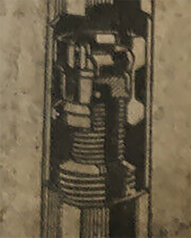

Maybe this is closer to the era you are looking for. It's from Self-propelled Vehicles Theo. Audel & Company 1910.
I suspect there were a number of different choices in those days.
I knew I was out of the norm when the Schraders with the slot for removing the valve core were referred to as the "screwdriver type" by some modern vendors. :lol:

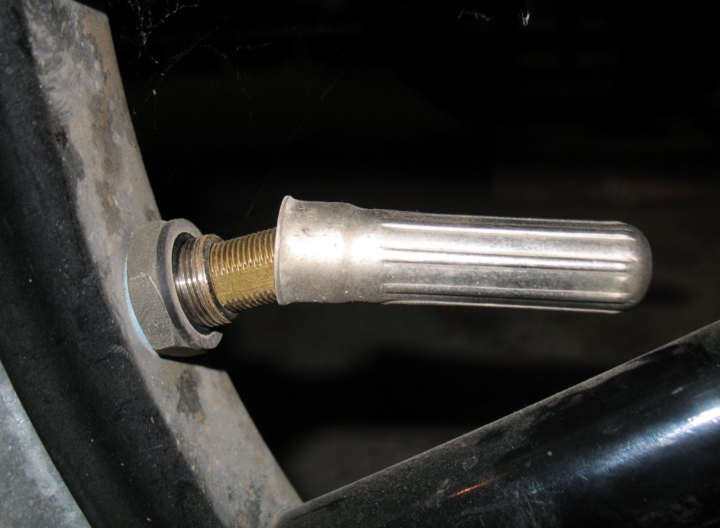

If you look through a box of swap meet valve stems, nuts, and covers, you'll see that there's a large variety, maybe larger than the variety of timers or spark plugs made over the years. I know which stems are correct (Schrader 777), but I'm not sure which of the many covers belong with them. I wanted covers now, not in the sweet by-and-by, so I went with the ones I could find enough of to make full sets. No doubt somebody will be offended by my settling for the incorrect covers (everything offends somebody these days), but I am an insensitive clod and don't care. :)
I use these nickel era covers because they're the ones I could find in great condition.
These covers can be used on the correct Ford stems or the incorrect larger stems I use, depending on which nut is used. These incorrect larger stems are the size used on all of today's metal stemmed tubes.

The dust cover that Steve posted looks correct to me. The repros have a slight ledge under the knurl.

I have seen the Ford drawings at the Benson Ford Research Center for the Dill and Schrader style dust covers that Rich posted pictures of, so obviously Ford supplied parts. I do not remember the exact year of the Schrader style drawing, but the Dill style drawing was I think dated 1925 or 1926 or 1927. Both style dust covers were nickel plated, so not right for a 1914 or 1916 T, dont know about a 1910 Buick. The modern brass stem inner tubes have the stem diameter too large for the Dill and the correct small neck Schrader dust cover to fit over, but the larger base Schrader dust cover posted by Steve will fit perfectly and that is what I have on my car. I never tried the Dill style on a rubber stem inner tube but it makes sense they will work provided the stem diameter is small enough.
