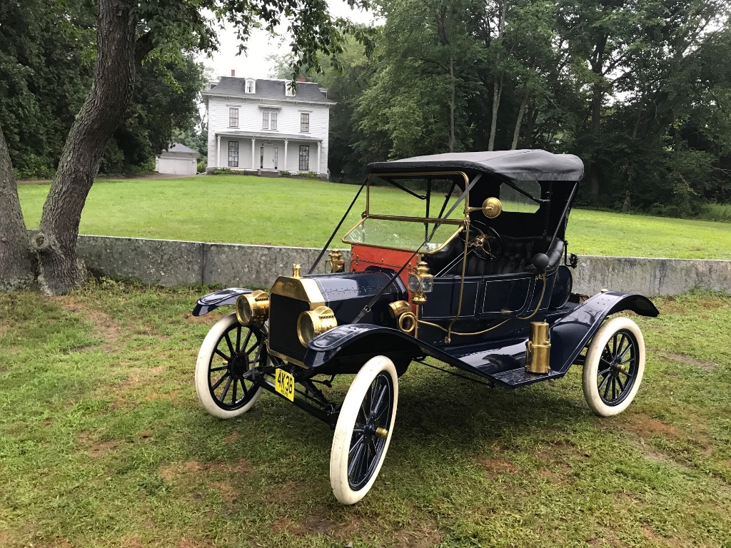

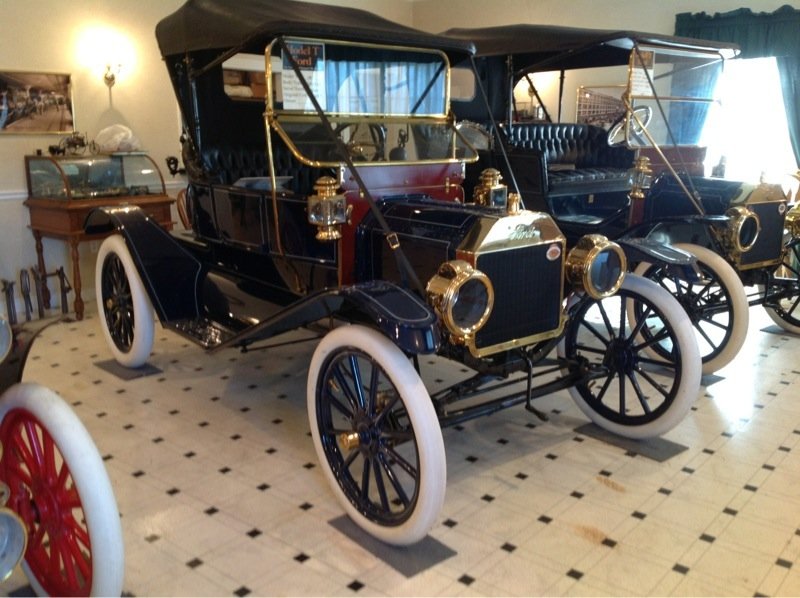

Post by TRDxB2 » Fri Oct 14, 2022 9:32 pm
Two local Torpedo's, not mine :cry:
Craig Beek's (available $$$)
Private Collector - Recent Restoration

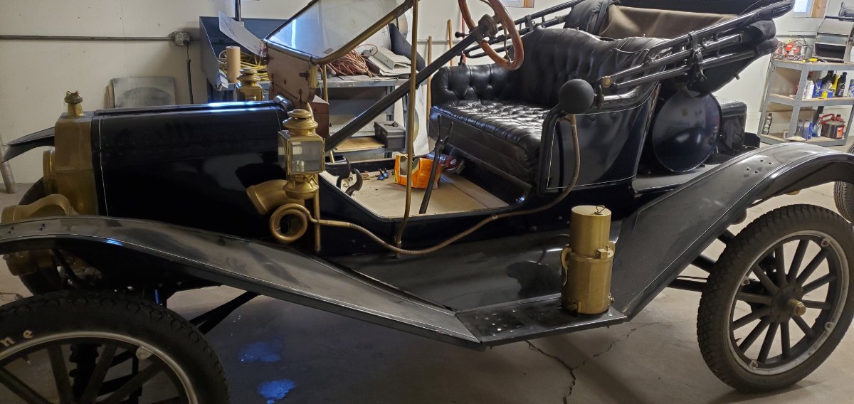

Post by Tim D » Sun Oct 16, 2022 5:12 pm
Here is a picture of mine. I have the correct wheels they need new spokes.

Post by Gen3AntiqueAuto » Sun Oct 16, 2022 6:22 pm
Tim D
Is that car in nuetral in that photo or e-brake on? I'm seeing different torpedos, one is straight up for high gear and the next looks like it's straight up for nuetral like any other.

Post by TWrenn » Sun Oct 16, 2022 6:51 pm
Tim...
That cars lever looks to be in "park mode" as it is leaning towards the seat.
On my Torpedo, straight up is actually fully in park, as mine also has RM brakes, and that changes how the lever travels.

Post by Tim D » Sun Oct 16, 2022 10:12 pm
E brake is on. Shoes could be worn down it has a lot of miles on them.

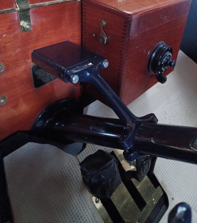

Post by lnoller » Wed Oct 19, 2022 2:42 pm
Takes a very special steering shaft bracket due to the column being at a different angle.
Larry...like this one?
Note my hi-tech "pedal extender" for my short legs! :lol:
