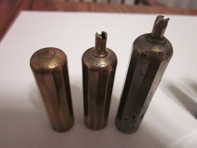

Tad
buy a set of vintage DILL covers. They screw onto the thread that the valve stem cap threads onto, and the part that screws onto the stem slides up/down within the dill cover and stays put when tightened down...meaning that a stem that protrudes from 1/2" to 2" will fit inside these:
They show up on eBay from time to time and I'd suggest you place a WANT AD in the Forum...you'll easily end up with a matched set of 4 and never worry again about a car with 4 completely different length tube stems...the DILLs will adjust and fit them all

Steve, you hsve it backwards. Flaps are used on split rims and lockrng type wheels like TT rears. Rim liners are used in clinchers.
There are cheap plastic valve extensions available, as shown. They can be most unreliable in operation, particularly with their ability to properly depress the valve core when inflating the tyre. Truck tyre dealers will have precision made brass extensions which are are of excellent quality, but come at a cost penalty.
The Dill cover a Scott shows are an excellent alternative.

Taa, if you use the Dill valve/dust covers shown, there is no need to replace the rubber stem!
