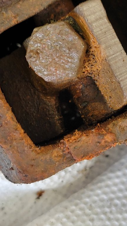

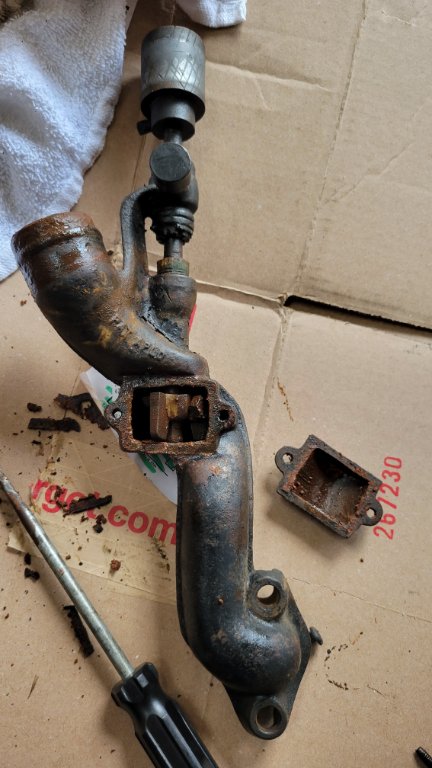

I pulled this water pump off of a T I recently purchased and I have a question. Given the design of this impeller, could it actually pump much water? I didn't expect the angle of the blades to be so parallel with the water flow. I'm not asking if water pumps are worth it as that has been rehashed many times. I'm just curious if this one would even work.

It would move some water, at least at higher speeds. Is the impeller as designed, or has it been repaired? From what I've seen, the T accessory pumps were not designed to be high volume pumps. The small diameter of the impellers, and inefficient volute design would only give a gentle flow. That was all that was needed or desired in a system with no thermostat, no pressure cap, and capable of operating on thermosyphon. A high volume pump would consume more power and would force water out the overflow pipe at higher speeds. A high volume, rope packed pump would also tend to suck air in at the shaft seal at higher speeds. A pump with excess volume capability works well in a thermostat regulated system with a pressure cap. The thermostat provides restriction, even when fully opened, and that choking effect throttles the pump at higher speeds, which provides some overpressure in the block and head while limiting the pump's power demand. The Model A pump is also intentionally limited as to volume, and another reason, in addition to those above, for soing so on the Model A setup is to prevent the pump from developing lower pressure in the block and head, which is the last thing you want to do.

It would very likely move water just fine. Those blades are tangent to the inlet (inclined) and square to the outlet.

This is the first time I've seen this impeller, so I don't know if it has ever been repaired. I pulled it because it was leaking badly, running or not.

It appears to have been broken and brazed back together. Also, seems to have an oversized bolt to lock it to the shaft.

A great many old pumps have worn or damaged shafts in the seal contact area. The accuracy and type of surface finish at the point where the seal contacts the shaft has to be right or the pump will need to have the packing adjusted very frequently and replaced often. Loose bearings will also assure poor results and the need for frequent adjustment. Debris in the coolant will cause issues with any kind of water pump. "Water pump grease" used to be widely available. As I recall, It was a yellowish, waxy grease. A pump would probably give the best service if the impeller was of a uniform shape and well-balanced. A T water pump might reach 3,000 RPM or more at high engine speeds.

Jerry VanOoteghem wrote: ↑Tue Nov 01, 2022 8:28 pmIt appears to have been broken and brazed back together. Also, seems to have an oversized bolt to lock it to the shaft.
I think that there is also a set screw to hold the bolt in place. It seems like a lot happened in that small space.

To answer the original question yes, it would. A duplicate of this pump has been on a fairly heavy 1924 Depot Hack with an original body and an original black high radiator that has been in our family for 65+ years. It keeps it cool here climbing the Vermont hills and mountains and never boils. It tried it once with the thermo-syphon system, but because the original 98 year old radiator doesn't transfer heat all that well it overheated fairly often without it.

While twiddling my thumbs waiting for an order from Langs, I started to clean this pump up and confirmed that there is no set screw holding the bolt. It was an oxidation and sediment formation. The bearings seems sound, with no play in them. This may be a rainy day rebuild project.Pep C Strebeck wrote: ↑Tue Nov 01, 2022 9:48 pmJerry VanOoteghem wrote: ↑Tue Nov 01, 2022 8:28 pmIt appears to have been broken and brazed back together. Also, seems to have an oversized bolt to lock it to the shaft.

Re: Would this water pump actually pump water?
Hi Dan,
I'm impressed getting the bolt out is usually when I break the impeller. It looks like you have the shaft out. If it is smooth and tight you can
probably repack it with new, clean repaint, and use. ( At your discretion) Keep in mind the packing stuffing nut is also a bushing, also remove
all the old packing.
Craig.
Craig.
