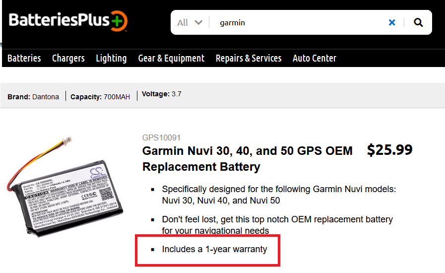

Well now.... Learned a few things about my Nuvi investigating yours that I didn't think about: 1. there is a fuse & 2. it has a battery (yeah! what was I thinking). The battery is likely the issue. When its plugged in your just charging it, when you turn the vehicle off it asks if you want it to stay on. The unit is 10 years old about the life of a lithium battery

The battery is a Garmin 361-00056-00 there are many seller's but need to make sure the replacement is "new". I'd get one from BatteriesPlus, price is about the same and they may even replace it for you for free, & if it doesn't work for them then you know the GPS is dead
