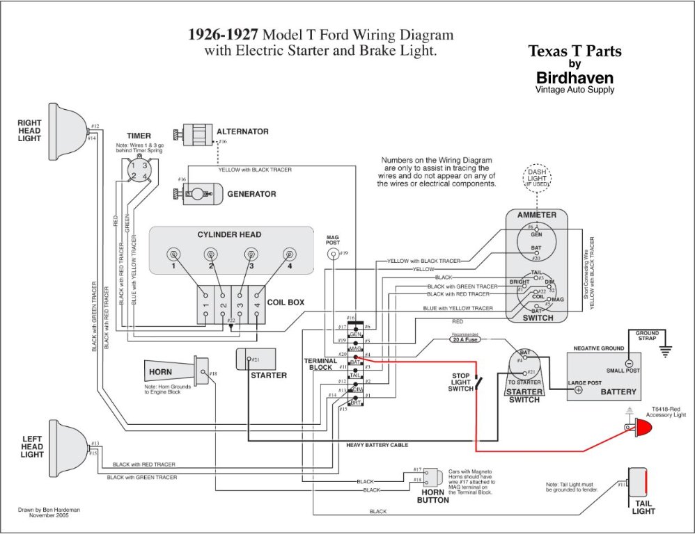

The wiring diagram you posted though electrically will work, but is not physically correct. There are many Model T wiring diagram floating around and most of them have errors.
This wiring diagram depicts problems that are part of very commonly misunderstood five wires in the Model T Ford charge and discharge circuits and will result in slightly dimmer headlights and the ammeter will not show a discharge when the horn button is depressed.
Some will say I am being too picky, but I learned the hard way. Many years ago when I first started helping folks with Model T electrical problems I was invariably told by the owner "the car is wired correctly" only to find out later it was not. Most of the problem centered upon those pesky commonly misunderstood five charge/discharge circuits wires. As far as I am concerned the car should be wired as it came from the factory; if for no other reason than to prevent confusion when future trouble shooting.
I refuse to help anyone with wiring problems unless they agree to use a wiring diagram I know for a fact are correct.
This is also why Bob Cascisa and I set out to make a set of wiring diagrams for Model T's that were absolutely correct.
Attached (last page) is a the correct wiring diagram you should be using when wiring and trouble shooting a 1926/27 Model T equipped with the FA starting and lighting system.

Reference the link for the proper diagram and save it for future reference.

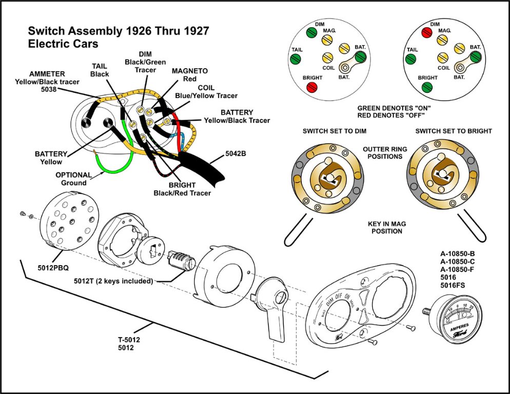

The ignition switch is actually two switches in one.
The key determines the source of power, inner ring, MAG OFF BAT. The handle operates the outer ring for lighting DIM (low headlight filament & tail light) ON (high headlight filament & tail light). The ammeter is an indicator of current flow, and not very accurate. With the engine off turning on the lights should cause the reading to go minus -, how much depends on the amperage of the bulbs. That's indicating that the power is coming from the battery. With the engine on and lights off the ammeter pointer should be showing a positive value +. That indicates that the power is coming from the generator. If you look at the 1926-27 wiring diagram and trace the wire from the magneto post to the terminal block,2, to the switch - nothing else is connected. When the switch is turned to MAG (or BAT) it completes the connection to the COIL position.
Note how the yellow & yellow traced wires connect to the outer BAT screw and a jumper connects to a second screw (used to power the coils). This allows for the lights to operate independently of he engine running
