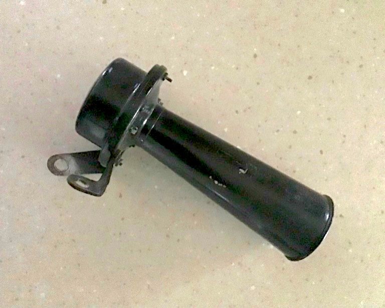

Does anyone here fix or restore the 6 volt horn for a 1924 ? The 24 I am putting back together has a horn that mounts on a head stud and water inlet bolt. I have tried jumping it to a 6 volt battery but get nothing. I took it apart and it all looks good inside, no broken wires, etc. I would buy one if someone has a working one for sale, but I thought I would see if anyone repairs them before putting a WTB ad in the classifieds. Thanks, Art

Is it a Ford horn? If it is look in the Ford service manual and there is some information in making adjustments. The set screw in the back of the diaphragm may need adjustment.
Remove the back cover and check the condition of the diaphragm. If it’s not rusted badly or rusted through it may be just a adjustment that’s needed. Replacement diaphragms are available from the parts houses if it needs replacing.

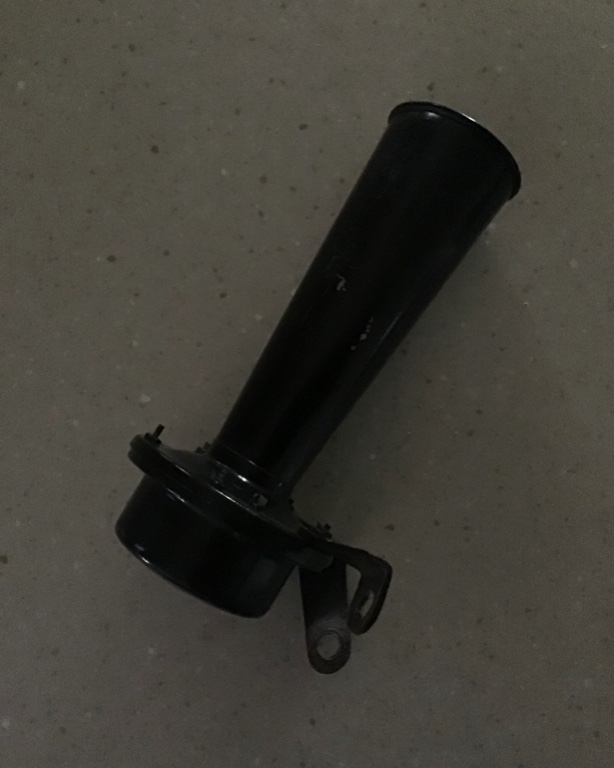

This horn looks the same but says Aimes. It does not say Ford. I'm going to take it apart again and have another look. Art

I bet we can get you beepin again remotely. I had to remake the points set and added a capacitor to mine to reduce the arc across the points. It’s very loud now and nice and touchy at the button! The adjustment is a little trial and error but not difficult. Start with just swiping an emery board or folded sandpaper (or heck, a point file if ya got one) between the contacts in there. Doesn’t take much dust or corrosion to interrupt the circuit and the gap adjustment does not seem to be super critical. Post a photo of it’s innards and the group can determine the steps to set it up easily I’m sure. Can’t have you without your dying goose on board! To me it’s one of the most fun parts of the T experience and I find I actually need it in traffic quite frequently around here, go figure… -Chris, in Boulder

Looks tidy enough in there! Wonder if those points are too far gone? Make sure that the wire is still insulated completely and the fiber washers on the post are not too dirty or broken down. You want no continuity between that wire and the housing. Try to file the points down a little more evenly so they contact each other more completely. You may have to loosen the two screws holding the “lower” points “bracket” and close up the gap a smidge. Maybe I read that it wants something like .16 but I might have imagined that just now too….If you try to move the plunger, is it already bottomed out? It needs enough motion to open the points and break the circuit then return and let them close up again creating the circuit. The set screw and locking nut up on top of the springy bar do that. Diaphragm looks ok but take it out and make sure it’s not frozen up or stuck somehow. Nice work getting in there for those close ups. Unless a wire is broken somewhere out of sight thing should honk!

I'd start by tightening that loose nut shown in your 1st photo.

That nut was tight, I had loosened it. Are the points supposed to be open or closed with no voltage applied? I put voltage to this and get nothing. Thanks, Art

The points should be closed with no voltage applied.
Can you check for continuity in the coils?
