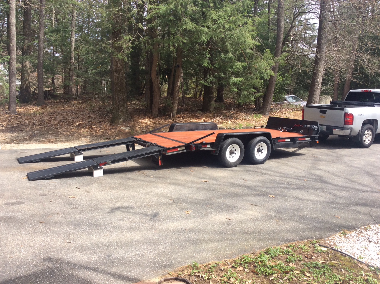

The ramps in place.
The angle matches the dovetail and they lock in place so there is no chance that they will move.
The winch came with two wireless remotes and two controls with extension cables.
After mounting a battery box and getting a new battery I remembered that there is a power lead in the wiring harness to the truck.

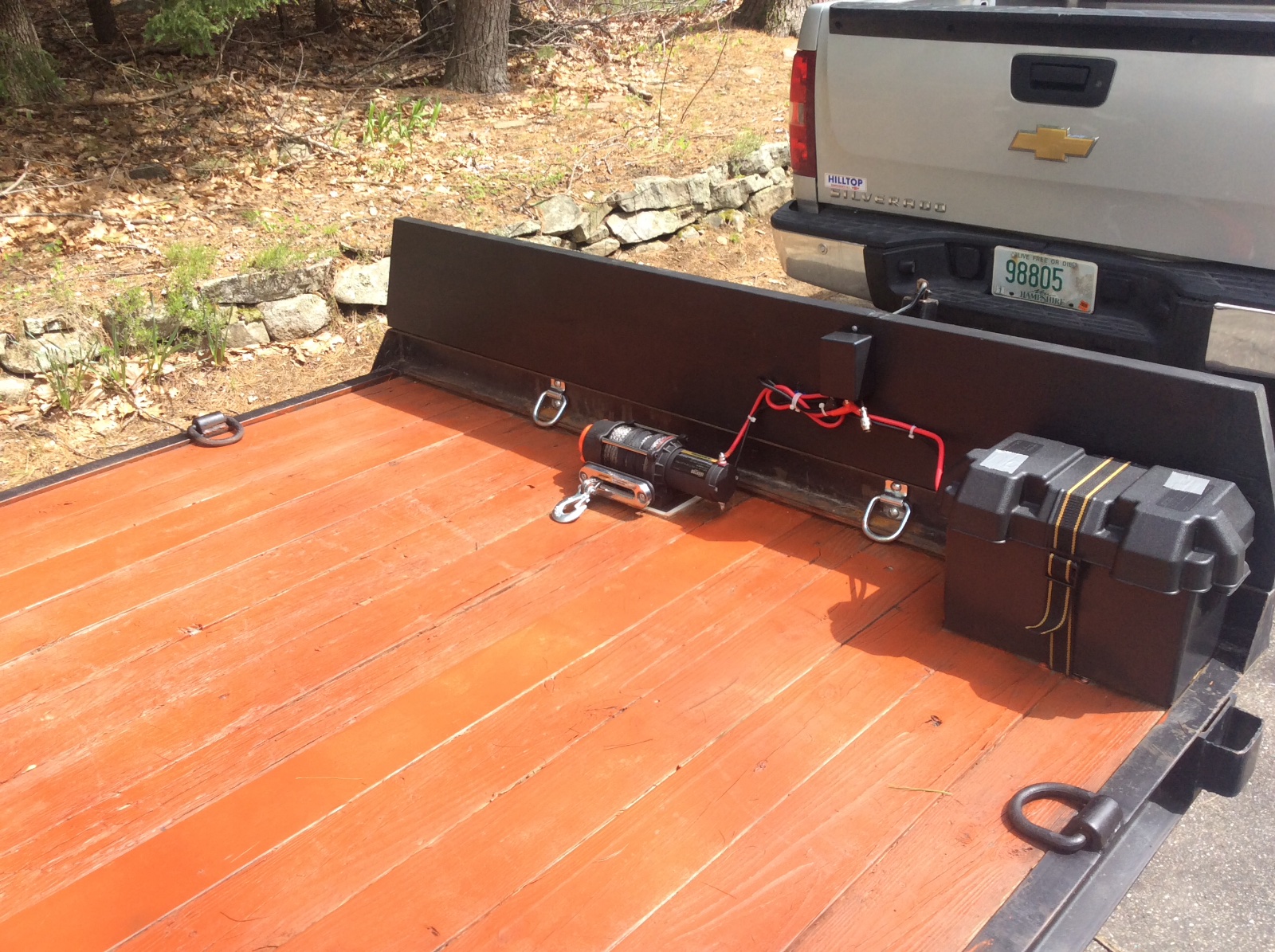

I had time to finish the trailer
Details of the additional ramps — now painted
The hardwood board locks into the trailer ramp keeping things together
All dressed up and ready to go.
Walmart has gallon of Glidden redwood stain for less than $10.
I couldn’t pass that up!
Winch and battery. The winch mounting bolts go thru a trailer crossmember.
