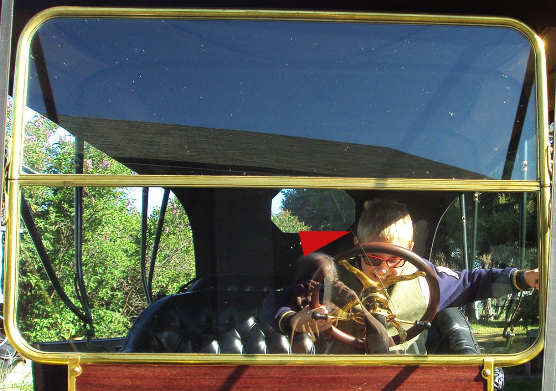

Speedway Motors brass setting channel fits their repro frames. Not sure about original brass frames. I've made three brass windshields from SM and it's not an easy job. If you're interested I wrote a rather lengthy piece some time ago about the procedure. I'm pretty sure I've saved it. Email me if you need a copy.
Langs has different size bedding dies they use for forming the corners of the setting channel for different applications. If your corners don't match the radii of the repro frames, give Steve a buzz and see what you can work out.

Be careful. Mine cracked when I installed the glass and also after I had the glass people install it. Also, on two others I used original glass channel.
I see others that have worked fine.

Thanks guys… I just wanted to make sure the kit from SM had all the pieces pre bent that would fit their frames. I tried to get info from SM but didn’t get very far as to what it all looks like. The picture on their website shows only 4 pieces. I did talk to Steve over at Langs and he told me about his process for bending the glass channel. He did offer a good piece of advice about getting 1/4” glass to fit in the channel though.
