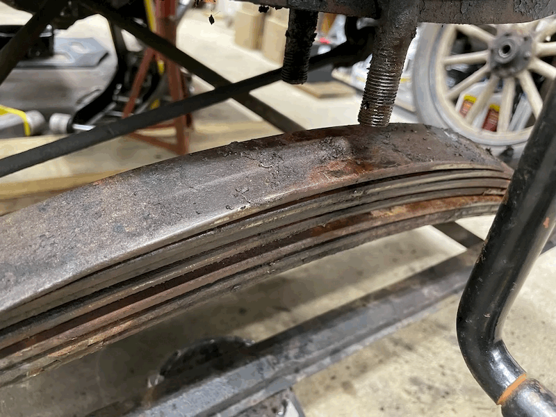

Has anyone ever seen a front spring like this? No bolt, just a dimple that one leaf sits into the dimple bottom of the next leaf. I've since changed it out for a new one.

I seem to recall an older post saying that was a design feature of a period aftermarket replacement spring.

I had 1 that was tapered leaf style. I drilled the leaves for a center bolt. Drill from the bottom, it's already center marked. You need a quality drill bit, turn it slow, lots of pressure and cutting oil.

Your spring is not a Model T spring! I've seen these many times, and they may have been used in buggies. There are two types of springs used in 1925.
The early ones used a 7 leaf spring as was used prior to 1925. The late ones use an 8 leaf spring which is the same as a 26-7, and sits 1 inch lower than the earlier design.

Wholeheartedly agree ! 'Cept for the buggy part. I have never seen a light horse-drawn vehicle with springs identical to a Model T. I believe Mark is right, non-factory aftermarket item.
? ? Woolgathering - that idea may be an improvement ? I've seen more than a few spring center bolts worn badly or sheared. On the other hand, how critical is the bolt head to keeping the frame centered on the springs ??

I had one also like Steve and drilled out the dimple and it has worked just fine. It is tough metal, get a good drill bit, rotate slow and lots of cutting oil. That spring was better than the Ford original. I also bought a new tapered front spring last year for a nother car and the taper is a joke. Drill out the old spring and you will have a good unit.
