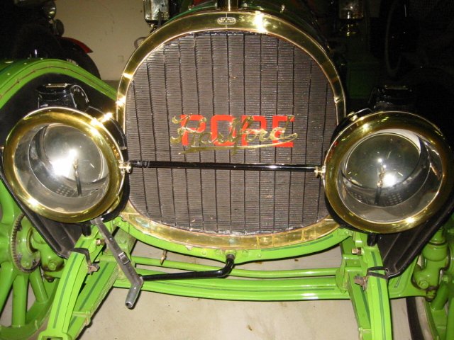

Correct, once you get around the 5-6" point a crank gets sketchy. If memory serves Sid does a dip but it is large (long) and doesnt look as nice as a short one. If you come across someone doing a short more aggressive drop let me know.

TheSpeedsterProject wrote:
Mon Nov 28, 2022 7:31 pm
I see no way that axle in your photo will lower the car. It's upside down but still - ????
Never said it would lower the car, it isn't supposed to. When you lower a car enough and try to run a crank the axle gets in the way so a dip is placed in the axle to clear the crank. This is noticeable on Many other manufactures in the early teens.

To clarify what Chad wrote above- this is a problem only when the axle is used with a suicide front end arrangement - when the front spring mount is moved upward to create the drop- this method drops the centerline of the crankshaft to where it intersects a stock height front axle, which causes the hand crank to hit the axle. The purpose of the "dip" is to get the axle center below the hand crank.

A stock T axle can impact the crank, when installed in a non-stock fashion, which was whole point of showing the "dipped" axle.

Slid a crank in for checking
Note where it has knocked the paint off
A good speedbump . . .
Note dip to avoid crank
Another factory dip
