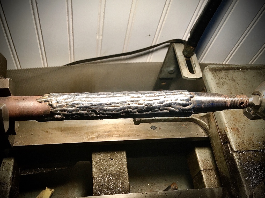

Rebuilding this column has been a lot of fun so far. I have enjoyed going thru it. I decided to try to save my steering shaft instead of buying one. Here’s some progress pictures.
the shaft was worn and wavy.“Whether you think you can, or think you can’t-you’re right.”

So I welded it up!

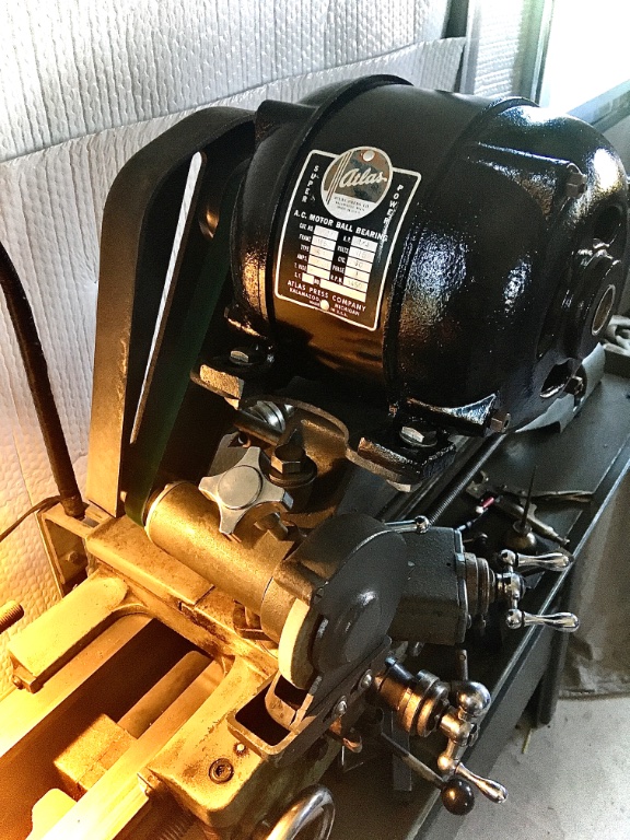

Then I broke out the Atlas tool post grinder!
Topic author - Posts: 1178
- First Name: Bryant
- Last Name: Shafer
Re: 1926 Steering Column
And finished the last few thou!

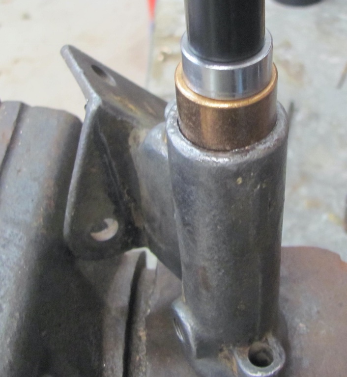

I am happy with the results.
Bryant
next I will size to a new bushing when it shows up.
Bryant

For those of you that have been here before what is a good clearance to aim for for the steering bracket bushing? The steering shaft is at .750
I can’t seem to find a general rule. Is this a by “feel” thing. I did see in the book the gear case clearance is not to be over .006 so I guess I know what to much is. Thanks
Bryant
Bryant

I had .750 in a few spots so that’s what I chose. The newly surfaced part is definitely .750 and the bushing I received today appears to come in at .749.

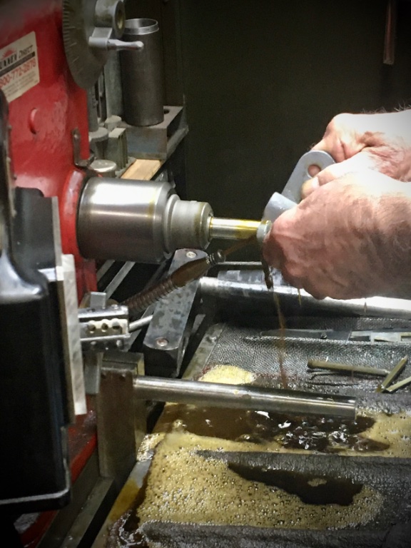

So my work reamer pile did not produce the proper size for the job so I decided to stop by a friends machine shop on the way home. After careful consideration we decided to do the job on the Sunnen. Pressed the bushing in on the trusty Arbor press . Started the honing process to get the bushing round and back to .750. Then pressed on until we hit .752. This proved to fit perfectly! Thanks Scott for the measurement.
Bryant“Whether you think you can, or think you can’t-you’re right.”

If I'd have known you had access to a Sunnen, I'd have suggested that over finding a specialty .752 reamer...those sorts of things cannot usually be found just lying around.
good for you and your good luck!
I think you might be shocked at how well your car is going to handle after you're done with everything on the front end. That bushing is oddly often overlooked on overhauls and really is a key component. Solid, no-play action here pays big dividends.

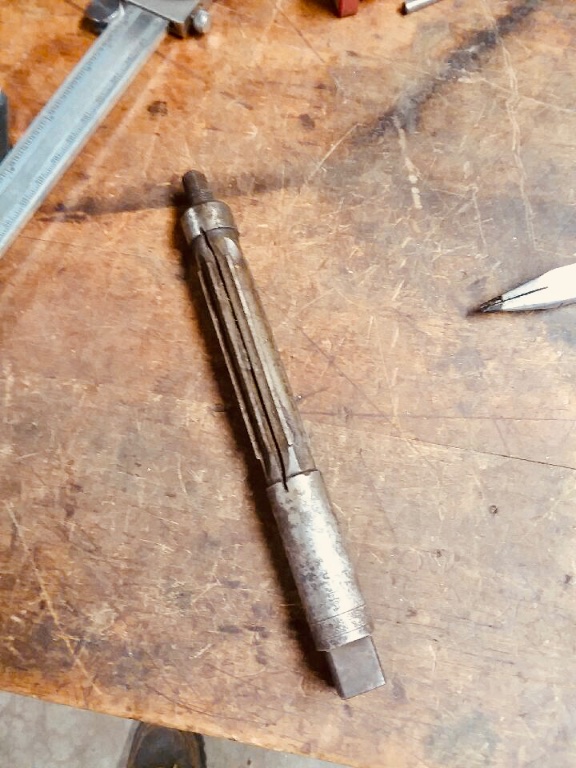

We actually stared at this adjustable reamer for a bit the Sunnen just sounded like more fun! Had a good time hanging out at the machine shop after work to.

Though I own a set of adjustable reamers I have never been pleased with the results, so don't use them.
I am almost certain that the old adjustable you show in your picture is actually an expansion reamer, meant to expand just enough to be reground back to original size (and left alone) and expanded again when dull, to be resharpened yet again. They were much more common years ago than now. Other pix people have posted are actually "adjustable reamers"
I mention this because you seem to be a "tool guy" and interested in doing nice work and caring for your tools perhaps beyond what the casual mechanic might do...figured you might appreciate the distinction in function and use.
Just a FYI
http://blog.supertoolinc.com/2015/02/03 ... e%20reamer.
Just a FYI

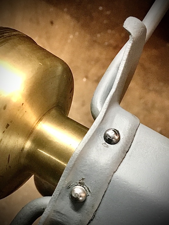

Finally finished up the column. Bucked some rivets, Peened some pins, greased, final primer coat and finish with some gloss black. Refurbished steering wheel and a fresh nickel gear case cover.
Bryant
next step will be installation to the frame. Thank you everyone for help
