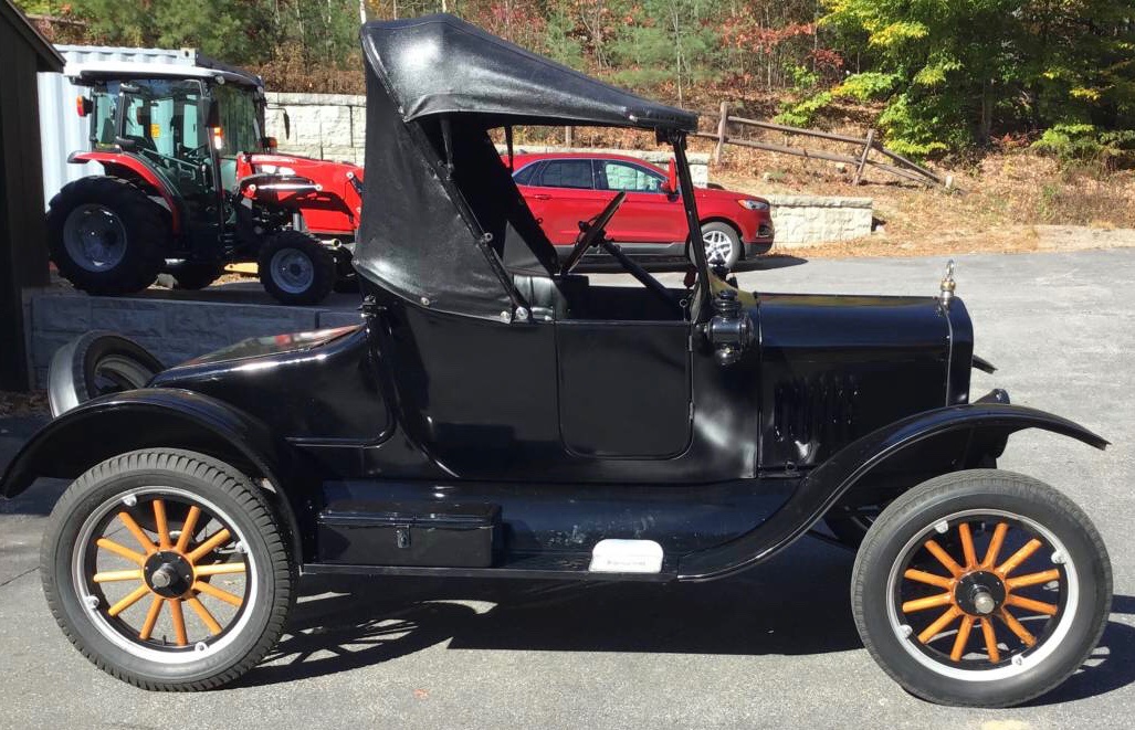

Recently I ran across an ad for a ‘25 Roadster and it struck me that this wasn’t the first time I’ve seen the top done wrong and in the same manner. Rear iron/bow too far forward and middle iron/bow too far back.
No way to correct it without installing a new top!

Maybe it was modified for an extra tall driver?...

Yes, maybe for a tall driver but, I’m 6’5” and sit okay in the factory design top. It just looks so wrong!

I keep looking at the geometry in the first photo. The top irons aren’t correct or the front irons have been lengthened. The rear bow is close to its correct location but the second bow needs to hinge forward. Doing so would push the front bow forward and past the windshield more than it currently is.
Definitely a DLR…Doesn’t Look Right.

To me the problem is the top irons. Either they are the wrong ones or they put the top material on when the top bows were in the wrong position. My 1919 Roadster would look similar if the front bow wasent moved to the correct position.

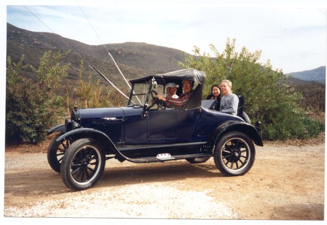

Don’t feel too bad Mark. Heres the worst::

George
having a hard time typing while convulsing with laughter! :lol:
A second look tells me that it can be put right in seconds, though.

George, that’s the worst one I’ve ever seen!

The car looks great. The top looks ... serviceable.

George, I agree. That top generates a good belly laugh. My 20 roadster was purchased after the prior owner ran into a too-low garage door. Friends helped him replace the top and the front irons didn't come low enough for the front lip to close the gap over the windshield. I talked to Mark at Classtique who sent me new straps and I was able to get enough stretch on a hot summer day to re-do it right.

Scott, et al,...that cut off touring in the pic I sent has had the top exactly like that for over the decade that I’ve known the owner. Hes satisfied with it...🤔
