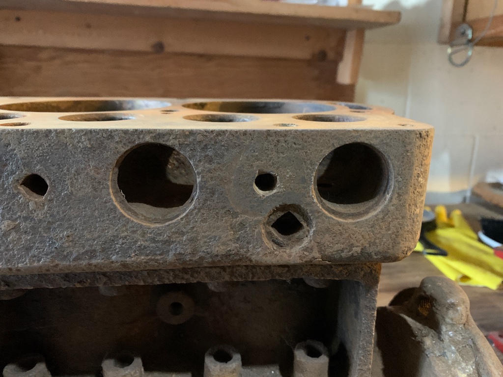

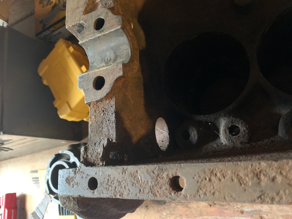

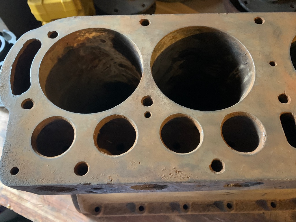

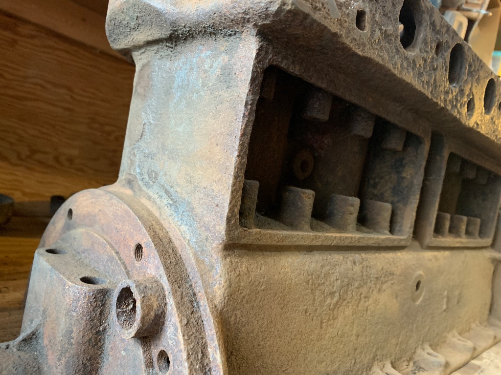

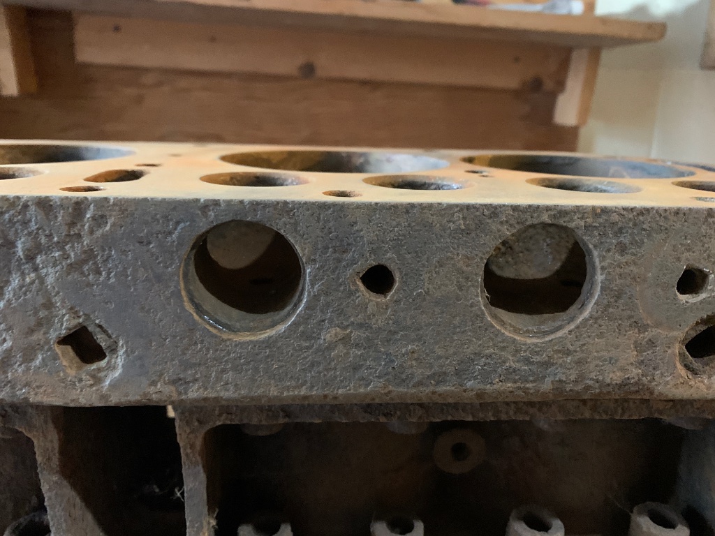

Dug this late 12 early 13 block out of storage. Heavily pitted on the manifold side near the last three ports (see pictures) Top section looks good with a few minor pits near the back section. Didn’t find any cracks but of course have not had it magna fluxed. I know with $$$ just about anything can be accomplished my question is would this block be a suitable candidate for rebuild or not.

A simple answer, yes, very repairable.

You have nothing to loose.(I do my best work with nothing to loose) Set the block up in a mill & take some cuts on the manifold side. You need clean surfaces around the outlet holes. The equivalent of a valve seat could be machined into the port holes. Ignore lower pitting. I would do a pressure test first. There may not be enough metal left in the water jackets. By the rear foundry plug, it looks paper thin. Some things cant be saved feasibly.

I have used valve seats to repair exhaust ports, JB does wonders on gasket area's. I have had some cast welded that looked like Frankenstine when they came back but some JB and bondo you can dress the outsides up.

Surprisingly the babbitt still looks good going by the photos. Machine the exhaust/ intake port side a bit and repair the freeze plugs. I was going to say use JB Weld to fill in any pits anywhere else and it will be OK. I don’t know if you’ve mike’d the cylinders but the bores may be better than you think. I wonder if the cylinders are pitted like the rest of the block. Since it’s and early block makes it a good savable candidate.

It looks like the block sat outside for a good while but survived!

That is way better than the B series block I restored for my Chocolate van. The first thing I would do is have it crack tested, paying special close attention to the rear main bearing web. The early blocks are known to crack, starting with the stress riser adjacent to the land on which the main bearing bolt heads register.
Then I'd have the manifold face bronzed up and resurfaced.
Mine copped a set of sleeves back to standard, hardened valve seats to bring those back and a new set of valve guides. Basically, we used the casting and rebuilt the lot. It's done in excess of 30,000 miles now.
