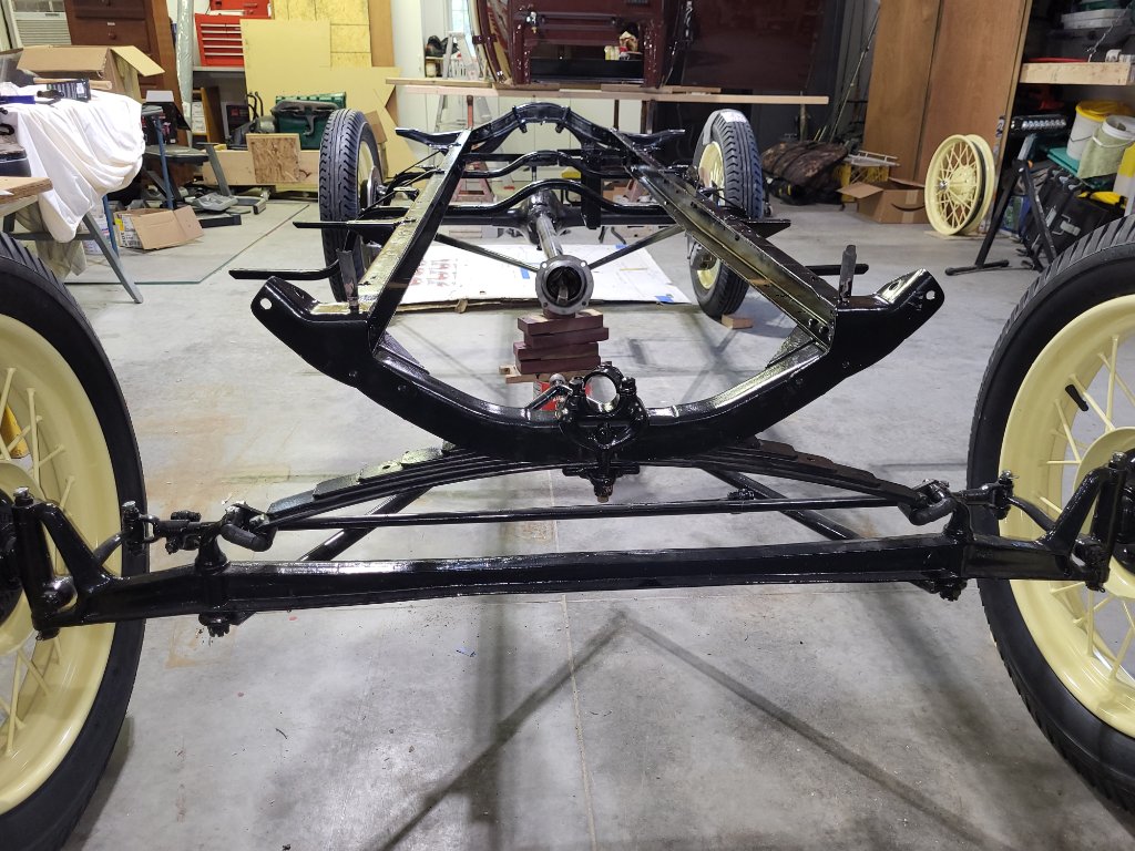

I will soon be putting the body back on the frame of my 1927 Coupe. I will be putting casters under the wheels to help in positioning the frame under the body.
Where is the best locations to place the jacks to get wheels onto the casters?
I think it is going to be difficult to get the frame positioned to insert the body bolts. Any suggestions?

Post by BLB27 » Tue Jan 03, 2023 5:18 pm
Photos were taken before the engine was installed.

Jack in the middle of the front axle to position casters under both front wheels but jack on both axle housings to individually place your casters under each rear wheels. . But I’m with Allan. More fun with friends lifting...🍺

They tell me the jacks are best placed as close to the wheels as possible. Some think there is danger of bending the rear axles.

I've never had a problem either. For jacking up a bare chassis with no body, you could place the jack just about anywhere. Not enough weight involved to hurt a thing.

On the early style before 1915, no not good idea to jack from center at rearend. I have never had any issues with center jacking the rearend on 15 up style.
Only thing I would suggest is putting a pad between the jack and axle, front or rear.

Not lifting the center of a rear end on a bodied car applies to all years.

Both front and rear, I place the jack as near the wheel as it will go without interfering with jack stands or dollies. Maybe I'm being too cautious. So what?
