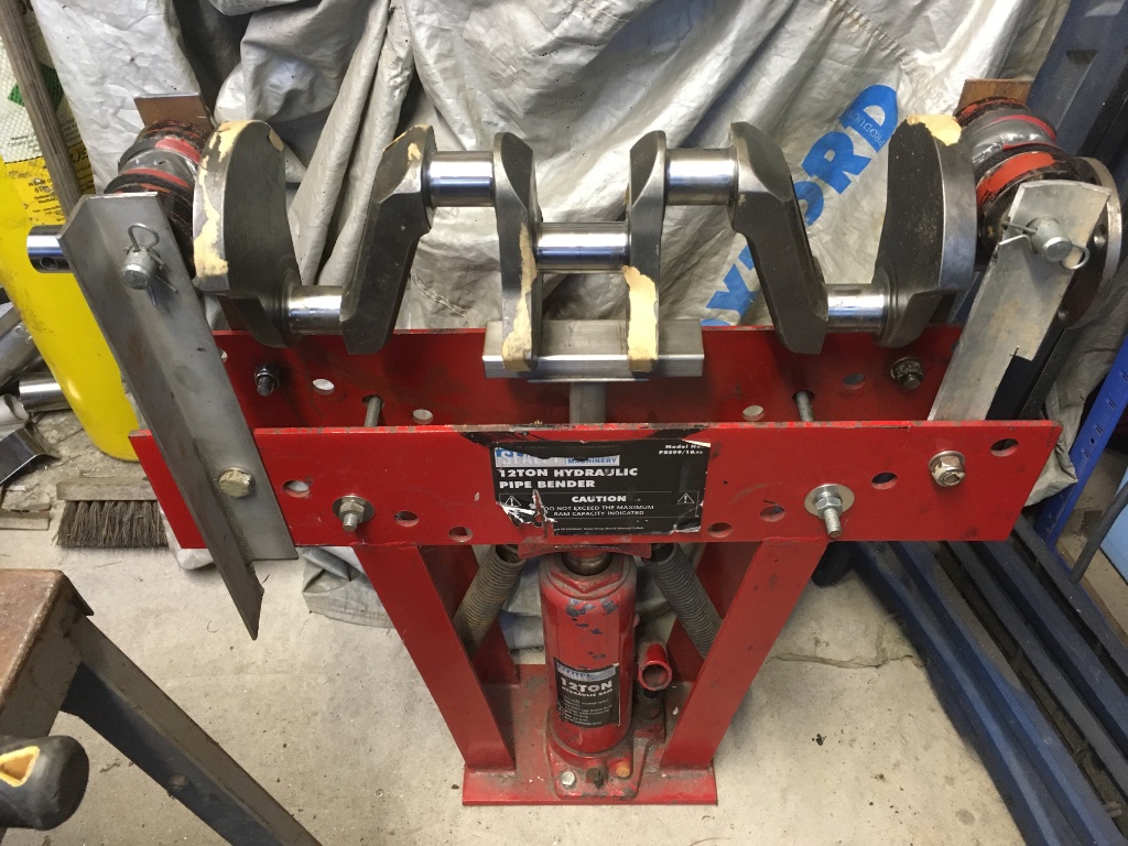

The far from justice bit worries me, partly as I am the type to get so fed up that I grab a plane and close that gap! However on the flip side, given the cost of a new crank, people have to both have trust in companies and companies have to engender that trust otherwise no one will buy cranks. I am hoping that Scat stands by their product. We do have, I think, a semi-official importer here in the UK, so possibly that might offer a solution to returning a crank.
I am not adverse to straightening it, but only after agreement and sizeable discount as for one thing that will cost cash and for the second thing that would then stick me in the place of no warranty and no comebacks.

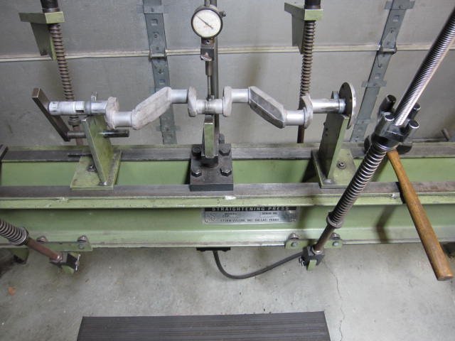

So if I’m reading this right you are getting a dial indicator reading of.004”. So this translates into actually.002” of bend. Laying flat for that length of time would easily cause this. Personally I would just use it as that amount of deflection would not concern me. I’ve been building T engines for almost 50 years and some really high performance ones!
Re: Bent Scat crankshaft
Post by Norman Kling » Sat Nov 26, 2022 2:14 pm
Be careful of trying to straighten the crank. You MUST find someone familiar with the process and trustworthy. I once had a crank with no need to be turned but took it to a shop to be magnafluxed for cracks. They told me there were no cracks but needed to be straightened. I asked them if they had the equipment to straighten it and was told yes. After they worked on it, I took it to our local bearing pouring shop and they miked the crank and found the mains 50 thousandth under and the rods 30 under. Apparently all they did was turn the bearings until they all lined up! That was when I installed a SKAT crank and have had no problems with it. I then took my old crank to an auction with our local club and I labeled it and what size the journals were. Someone actually bought it. I don't remember whom nor whether or not they had trouble with it or ever used it?

To begin with, before becoming too alarmed I would switch V blocks and use blocks that have a much wider surface for the front and rear pin. The reason for this is to eliminate the possibility of the pin wanting to climb the angle portion of the 'V' thus causing the error in the indicator reading. My V blocks are 2.000" wide to properly support the crankshaft which I would consider a minimum width to use. So with this said, lets move on.
To begin with, I think you are expecting more rigidity from the crankshaft than is possible with a shaft that has a 1.250" pin connecting to the webs. The weight alone from the beefier webs and the counterweights will cause deflection. If what you were measuring was deflection and calling runout, I would say that is nothing to be concerned with. That is the reason why the engine had 3 main bearings instead of two, ...and why the preference would likely be for 5 main bearings.
The next test I would do immediately is to check the flange run-out in a medial runout movement (-or the perimeter of the flange moving fore & aft) during rotation. If there is not any movement, that would likely suggest the unmachined forging was pinched too tight during the grinding process. My crank grinder (Storm Vulcan #15) uses centers to support the crankshaft which I find it is VERY easy to 'over-pinch' a T crank during setup. That is why grinders use a steadyrest to support the center bearing of the crankshaft during grinding. If you do find runout in the rear flange (-which I suspect you will), then your third test needs to use a set of three matched 2" wide V blocks to support the crank on a granite surface block or a ground surface such as a Mill table bed. Then take your measurements again reading the center main along with the rear flange to see if the support from the center journal pin corrects the problem. Also take notice for any pin journal taper. If the crankshaft was ground with runout in the center, you will likely see taper in the pin from one end towards the other end. On the Model-A crankshaft print that I have, it calls for a maximum of 0.0005" taper from end to end and no more than 0.00025 out of round. Modern crank grinding equipment can hit that ¼-thousandth measurement fairly easily but I would think that tolerance would have been greater back when the T was new. Maybe not??
I have taken the liberty to email you a copy of the A-6303 Model-A crankshaft so that you can read the verbiage the Ford engineers placed on the drawing for their Test Department (a/k/a Quality Control), but for reference here, Ford's engineers specified the Model-A crankshaft (-which was a much beefier crankshaft design) "WITH THE SHAFT MOUNTED ON TWO END BEARINGS THE CENTER BEARING MUST NOT RUNOUTOVER .002" TOTAL INDICATOR READING...". It also states "...THE AXES OF ALL PIN BEARINGS MUST LIE WITHIN .005" OF A COMMON PLANE PASSING THRU THE CENTERLINE OF THE KEYWAY AND THE CENTER OF THE MAIN BEARINGS..." which is the 'twist'. Now again, these are tolerances that were designated on a crankshaft that arguably is at least 50% stronger and maybe even more, -but since I do not have a print for the T crankshaft, that is the best I can suggest. So again, my takeaway is first support the crankshaft a tad better (listen to the screeching, rubbing sound in your video) and re-check. Next check the flange for runout. Based on your findings, follow-up with a 3rd support block.
One final comment, if the crankshaft does have run-out in the flange, then likely the crank is slightly bent. This can happen just from knocking it over on the floor, -or dropping it onto the table, -or a hundred other ways. When I remove a crank from my grinder, the first thing I do is check for it being bent, and most T cranks (-and A cranks too) will be out just a tad. They are very easily straightened by peening the crank. With the front and rear pins properly supported in V blocks, a rap or two by a hammer to a dull chisel hitting the cheek of the pin will straighten the crank. This is the fillet area on the main journal on the side that needs to draw (-shrink). This does not mar or damage the surface finish of the pin if done correctly, and is much superior IMO to using a press. Again, you have my email, so reach out if you have additional questions.

it is as good or better than i get when i have them ground. they are too small and flex like crazy.
in your situation i would run it. it is better than what i put in my engine and im driving. philip

I have some knowledge of precision engineering (built a boat and a plane, a real one that is), so I am not an engineer in the crank grinding sense, but I do know how to use micrometers, dial indicators, v blocks and such. The test that made me realise something was up was testing it in my used block. It should be noted that a straight crank would give the same result one up or other way up irregardless of the block - so if it rocked one way, then turning it through 180 degrees should not make a difference and it would still rock. Mine rocked one way and not the other. That is why I then stuck it on v blocks and verified it as in the video with a dial indicator - several times and the readings have been consistent.
I have now visited an engineering shop and they concur that the crank is bent by 4 thou. Straightening it will cost money and as their normal process would be to finish it off with a grind, that option is not open to me as my babbits are standard. So although I could convince them to do it the press way and leave it at that, they are less than impressed with that. If I do ask them to do it, I will be taking a huge risk (given how much the crank cost) and will be out of pocket and will also be out of warranty. I will also worry then that the crank has been compromised. Dependent on your view, perhaps I would not need to worry, but then I have seen the pictures of broken Scat cranks. Perhaps they were installed wrong with misaligned pans, or perhaps they were bent.

I have straightened several cranks over the years. Nothing wrong in the way Robert has determined the run out on his new crank, the fact is it is out. over 50 years of engine re-building and machining, I would not except that amount of run out, engine engineering books on specs will give you .0025" at the max, less is what one would be striving for.

However the crank could be straightened but I would wait to hear back from Lang's, Have you tried directly contacting former owner of SCAT?
Tom Lieb <tlieb@ScatEnterprises.com>
Problem with straightening your crank is they may have ground it with too much force on center main causing the out of round.
If the crank is bent from being dropped then by using the setup I have shown above, you may be able to peen it back as you mentioned other machine shop.
With so little off they could use a brass peen and wouldn't cause damage to crank rather than regrinding. But Time is money.
Bob, it is NOT my intent to upset you nor argue with you, but if your "engineering shop" has a normal protocol to straighten your crank and then re-grind it, ...IMO you really need to find a shop that is knowledgeable about, and has proper experience on vintage crankshafts. As I mentioned above, a press is not how you would straighten that SCAT crankshaft. It is to be done with peening, ...which does not damage the surface.
Also, with the comment about Nitriding, to be clear to others who may have the same misunderstanding, the surface hardening is done on many crankshafts that survive re-grinding and post-peening to straighten without damage. Therefore straightening a crankshaft (-either pre-grinding or post-grinding) that has been surface hardened has no ill affect whatsoever as long as the process was properly done.
As someone with experience in straightening crankshafts, I do not feel there is any risk involved however based on your comments both above and in your video, do you think at this point it would be best for you to ship this crankshaft back to Langs and seek some sort of a refund. At that point, I would be happy to either purchase your crank from Don or correct it for him. Likely there are other T engine shops that would do the same.
While I do feel badly for you experiencing this struggle, we are in a new day & time where staffing issues, lack of material availabilities when needed, and labor shortages have greatly impacted our hobby. I am not making excuses for SCAT, but at least we still have one manufacturer still able to produce quality aftermarket T crankshafts. SCAT manufactures T cranks as a convenience for us, -and not as a necessity!! Their plate is WAY overfilled with producing crankshafts & components for the racing aftermarket. And a final FWIW, it has been my experience that when I needed a new crankshaft made from billet for a vintage engine, the wait time was similar to yours with the final cost about triple to what you paid. I feel if you will be patient and quietly let Langs and SCAT correct the issue, they will make it right. Until then, keep the faith.

So, it’s a new year and still no response from Scat… They never did come back and I know many on here will feel that we should be grateful that they provide replacements shafts, but not even replying to emails to a customer who spent $1500 is just rude.
However everything has moved on. Langs were very helpful and gave me a discount to help cover cost of straightening the shaft. So after some fear, trepidation and such, I now have a straight crank shaft (well at 0.00025 or so, blimin straight enough!) and need to begin the reassembly process.
Thanks to everyone for the advice and thanks to Langs for being so helpful.

I ended up straightening the crank myself. This was in part due to a recent bad experience with an engineering firm who twisted my con rods whilst charging me an exorbitant sum for boring out the Babbitt. Nevertheless messing with the crank was not fun as to mess with such an expensive part feels wrong and brings with it risk that I had not really wanted to take. However the result was good and I am happy that I did it with the least stress possible (well least stress to the crank - me? I was very stressed!).

Just in case future people have a similar problem and wonder how I did it, here is the final video which I hesitate to post as it is not very good and I feel quite self conscious…
https://www.youtube.com/watch?v=F6DsNxP9hio
if people prefer not to click on YouTube, then I used a modified pipe bender. I had planned to buy a hydraulic press, but just as I went to click ‘buy’ I realised that it would struggle to fit in the sort of press I could afford as the length would be difficult to accommodate. So I added some bars to my pipe bender so the crank would sit above it:
My pipe bender is 12 ton, but I think I only used a very small portion of that capacity - perhaps as small as 1-2 tons. I did it in three hits. The first one shifted it 1 thou, 2nd time it was about another thou and the the final time, it went to just about perfect. People talked about elasticity of the Model T cranks, I am not sure the Scat has the same elastic nature, but I have measured it yesterday a few days after I straightened it and it is still where I left it at under half a thou from straight (0.0005 that is), so it is stable. Now I am just waiting on my con rods and then it will be reassembly time.
