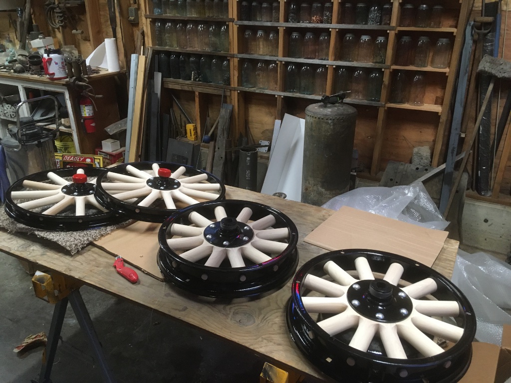

I have had Stutzman's rebuild all 4 wheels on the 15 runabout that I restored, and one of the wheels on the 11 that I just finished restoring. In each case I think that it was about 3 weeks for them to rebuild them. The runabout wheel parts I had primed and painted, but that was a mistake because they will get scratched up by them during the rebuild process. The 11 wheel I just sent primed parts. It too came back scratched, but was no big deal because I was going to paint it anyway. The parts might fare better if they were powder coated, but I don't know if that would cause some fit issues on the hub pieces upon assembly.

I took 2 wheels to Ohio 18 months ago. I had the hubs and rims cleaned up and repainted. Maybe they should have been in primer. The wheels came back perfect. They were sanded better than I could do. All I had to do was paint them and that put a second coat of paint on the rims n hubs. I know it was not expensive. I think it was just under $400 for two wheels including shipping. He let me put it on a credit card as well, if I remember correctly. When the wheels were done he called and I paid.

The 20" TT wheels are heftier and were a little more, but I recall the Stutzman
bill was about $1100 for fronts and rears (4), with return shipping. Noah's got a
better shipping rate than I got sending the parts to him ... I think that was about
$400. Add in sandblasting and powdercoating, I figured I was about $1700 deep,
all said and done.
