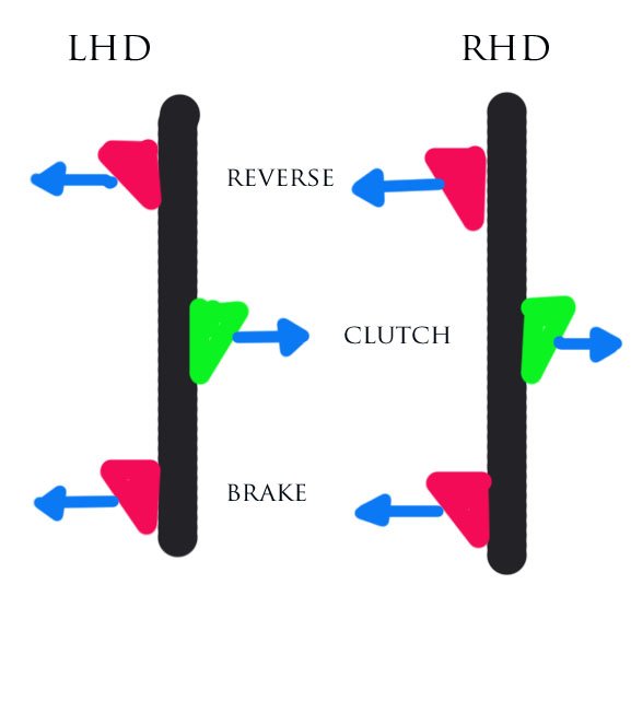

Norm, the pedal action for both RHD & LHD are the same.
Reverse and brake pedal shaft move to the left
The low pedal moves to the right.
This drawing shows the action
The black vertical line is the HH
On LHD the cams are on the outside for Reverse and Brake the Low cam is inside
On RHD the R & B is on the inside and the Low is outside.
Pushing the pedals results in the same sideways movement and clamping action of the drums.
