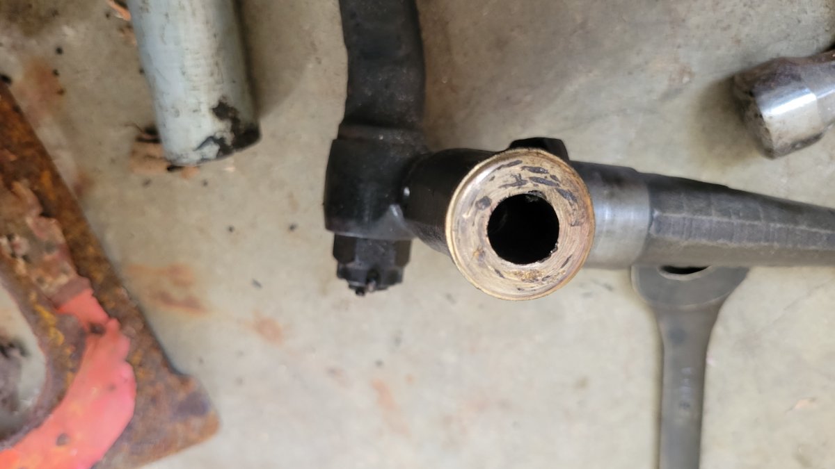

Used the bushing driver to force the bushings out. This was easier than I expected, although I did have to push a screwdriver into the spindle and bushing driver in order to widen it enough to catch the bushing. (photo) Then I used a block of wood to hammer the bushing driver.
Old vs. new bushings...
