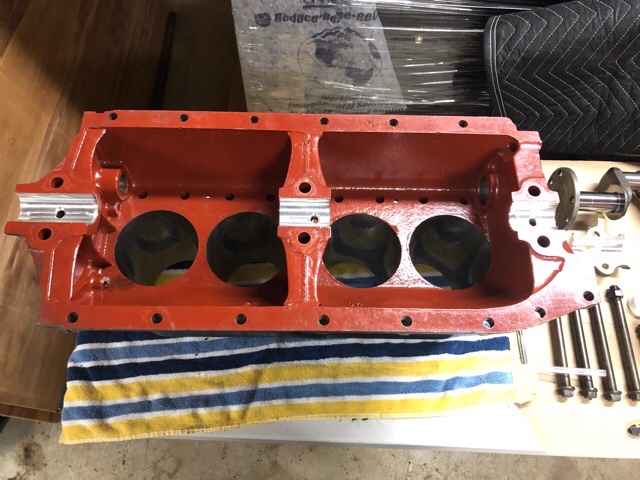

Re: TT Progress
Before and after! Went and picked up the short block for my 27 TT today with my uncle. Cylinders bored 0.040 over to be fitted with new aluminum pistons, rod journals 0.030 under and the mains are 0.025 under. Sadly it’s the first and only time this crank will be ground but hopefully it’ll have a long happy life. New crank gear also installed. I went ahead and had them install hardened valve seats and they had a set of modern big head valves fitted. Rods and cam bearings are on order from California. Transmission is rebuilt and ready. I still need to charge magnets and build the flywheel. There’s a Chaffin 0.280 cam and Prus head on the shelf ready for install. Still need to get a new cam gear. It’s come a long way from where it was just under a year ago but the project is coming along very well! I hope to have everything buttoned up and driving this spring. Time to get to work!

This one took some brain power. Finally figured out how to run the throttle control with the Model A carb without a hole through the block since it’s a late 27. Lokar cable and some flat bar. Remember kids, a grinder and paint makes the welder I ain’t!
- Posts: 4681
Re: TT Progress
Your TT is looking great and thanks for the nice detailed photos you provided!
I was looking at your engine photos and I missed seeing the internal oil line that runs from the front to the back of the engine. I’m sure it’s in there but sometimes it gets overlooked and forgotten about. I’ve been there and done that and noticed my wasn’t installed when I was setting the block on the engine!

Re: TT Progress
You had me questioning myself John! I had to go back and check pictures but I’m positive I put it in.John kuehn wrote: ↑Wed Nov 01, 2023 9:06 pmYour TT is looking great and thanks for the nice detailed photos you provided!
