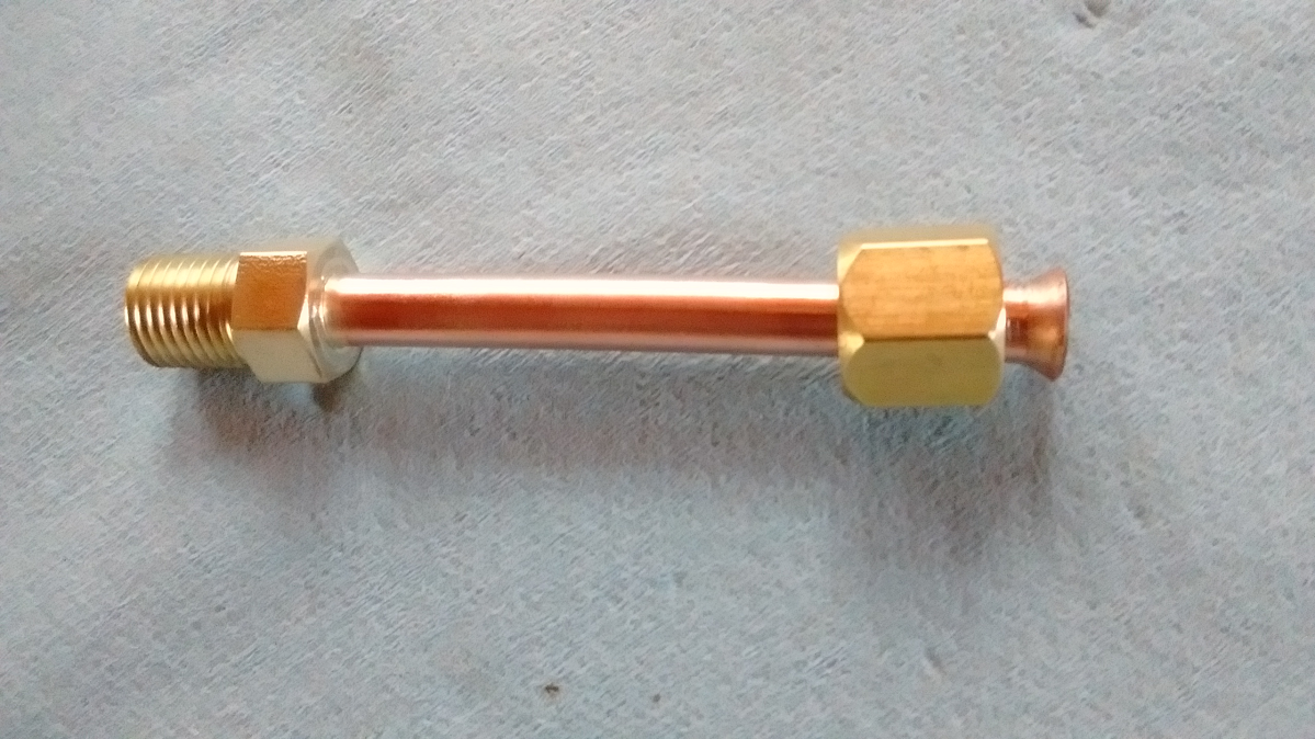

BTW, nearly every S4BF that comes along lacks the correct fuel hook-up. That fitting on the carb takes a 5/16 flare (5/16 copper pipe about 5" long with a Model T specific fuel fitting on the end).

Hi Scott,
are you still making the fuel line?
thank you , John
thank you , John

John
I haven't made any for about a year and I think I'm out of stock...I'll check
I'm out of stock but may make some this summer

Thank you Scott........bring on summer!!
John
John
