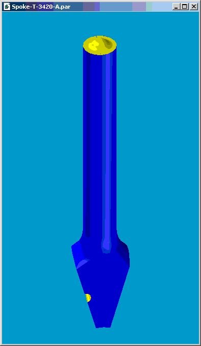

Re: Have we got an odd ball felloe
The spoke end has a neatly round nub that must be perfectly made to fit the inside of the dimple.
I don't know who used them, and have only seen a very few up close over the years. The Sayers touring car project I had many years ago had two wrong wheels on it that had that type. Those wheels were not model T size, and according to the hubcaps may have been from a Chandler. I have seen a couple others that were model T size.
I have one such rim in model T size, and a Hayes model T rim fits perfectly. The notches for the fixed lugs, and valve stem holes all line up correctly and look like they were made for each other.
Again, I do not know if these were originally made for the T model or not. If someone has a couple and wants to put together a set of these to use (for whatever silly reason?), mine would be available. I don't know who I would recommend to make the spokes for them. They have to made very precisely for the wheels to be tight and reasonably safe.

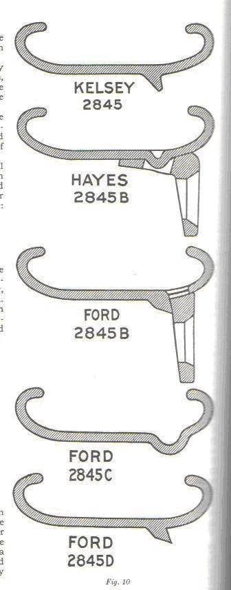

Summary: Yes original Fords were supplied with wheels that used those "odd to us" shaped spokes. I do NOT know the dates or which suppliers provided them.
Additional details:
At http://www.mtfca.com/discus/messages/411944/437128.html Scott Batta posted a similar question with the photos below of his 30 x 3 1/2 wheels.
Also notice that Rim B in Scott's picture can be used with any of the Ford supplied 30 x 3 1/2 demountable rims EXCEPT the Kelsey no88 demountable loose lug rims. So the Hayes 2845B fix lug rim; the Ford 2845B fixed lug rim; the Ford 2845C loose lug rim; and the Ford 2845D loose lug rim should all be usable on the that felloe. Why? It has the notches to allow the feet of the fixed lug Hayes rims to work as well and the cup around the valve stem that is needed by the 2845C & 2845D rims. The appropriate lug nuts and/or removable lug & nut would need to be used for the appropriate rim. Rim profiles shown below are from the Jan 1924 "Ford Service Bulletins." [Note the Ford 2845C & Ford 2845 were produced by various companies for Ford use. Firestone and Cleveland were two of those companies. ]
In that same posting and re-posted below is the illustration Tom Mullin originally posted on the MTFCI forum [but that forum is no longer available]. Tom used the computer to illustrate that spoke. He got the information from the Ford Archives and it shows that Ford had a factory drawing for that type of spoke. Note in the Price List of Parts you will NOT find individual spokes for sale -- they are NOT listed. But the Factory Number (sometimes called drawing number) does still exist at the archives.
Note it is an optical illusion. If you look at it sometimes the drawing has a bump on the top and sometimes it appears to have a depression on the top. Based on the use of the spoke – it really has a bump upwards that fits into the depression/dimple of the metal fellow used with the demountable 30 x 3 1/2 rim.

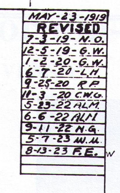

I have the Ford prints for these style spokes and felloes, so Ford did make this style wheel at some point.

Adam,
If you can look in the top right hand corner of the Ford Factory Drawing (Print) you have of that spoke, it often has a box with the date the drawing was originally drawn and then dates of when changes to the drawing were accomplished. Below is a sample from Kelsey loose lug front wheel used 1919-1923 or so.
In this case we can see that the date of the first drawing was May 23, 1919. And that it had revisions all the way to Aug 13, 1923.
We also know from Bruce's "Model T Ford" page 224 and also the online version at: http://www.mtfca.com/encyclo/1919.htm that:
That the 1919 model year started Jan 1919 and under wheels he has:
WHEELS: ...... Demountable-rim wheels were standard on closed cars, and optional on the open models; used 30 by 3-1/2 tires all around.
So how did they have the demountable wheels on the cars before the "Factory Drawing" was produced? I'm wish I knew for sure. But one hypothesis (guess) is because they were purchasing a standard wheel from Kelsey that they were already producing. And they merely bored the center hole to fit the Model T Ford hub. They would then assemble the wheels using the Ford supplied hubs or there is a chance that Ford assembled the wheels using the Kelsey supplied spokes, felloes, etc. But either way -- Ford was not directing Kelsey how to do all the details.
Another possible guess is there was an earlier drawing but they didn't continue to update it, but started over with a new drawing. I don't think that happened -- but I don't know what did happen.
Those dates may or may not help us figure out when that style was used. In some cases they will also include a "Obsolete date" and in those cases we know that they planned to longer use that part. That sometimes was reversed at a later date -- but often times it was not.
