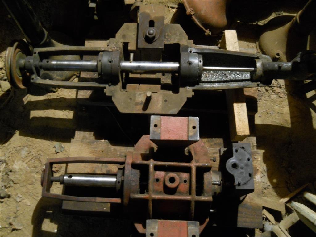

The line bore machine that I have used for 20 years or more. The “link” system assures me of correct gear fit.
Topic author - Posts: 5403
Re: Note to self: Make sure the boring bar is center in bearing...
Thanks for the photo, I see and understand now what you were talking about and how it works.
