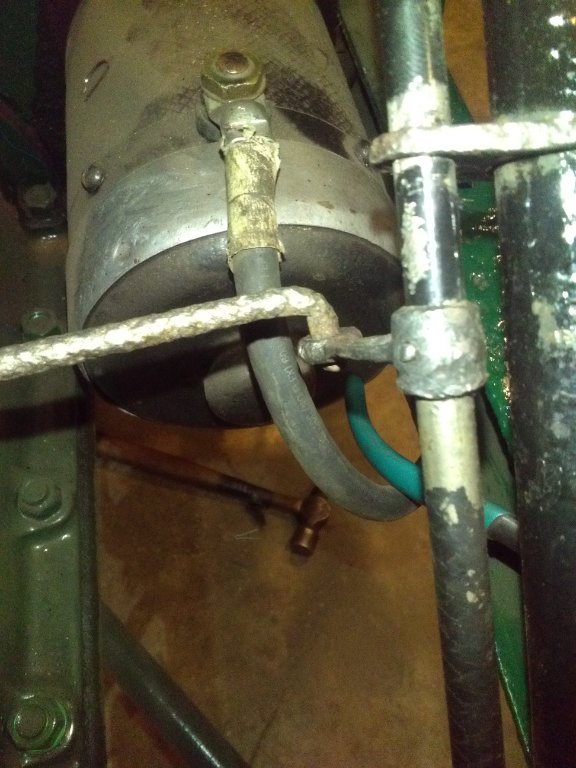

The switch to starter cable appears way too long - it is supposed to come from the rear of the car - the way it is routed now is an accident waiting to happen !

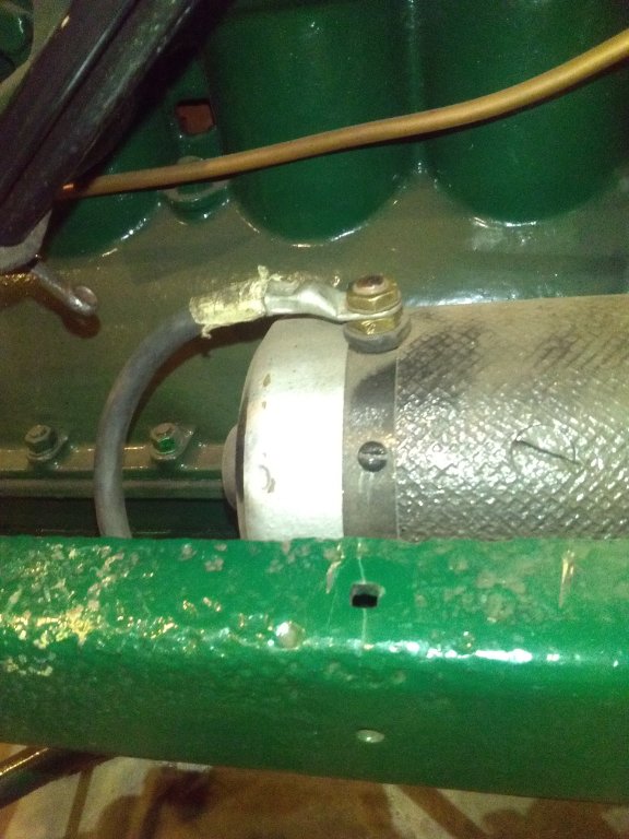

Help me out,what might happen? I don't quite understand. the cable is not close to anything,matter of fact it is very stiff and way heavier than needed, the blue pliers handle may be causing it to look funny?
Edit,I went to the shop and photoed it.

Mack if it touches the case of the starter you’ll have problems quick plus the way you have it mounted now it’s actually pulling on the post.

FWIW. The brass starter cable nut goes on top the insulator.
The steel nut goes on top of the cable.

I woke up at 4:30 this morning and it came to about the cable. If there is vibration or something bumps it ,the terminal would come down and arc. I don't why it took me a while to understand but hey,I am a bit slow.
