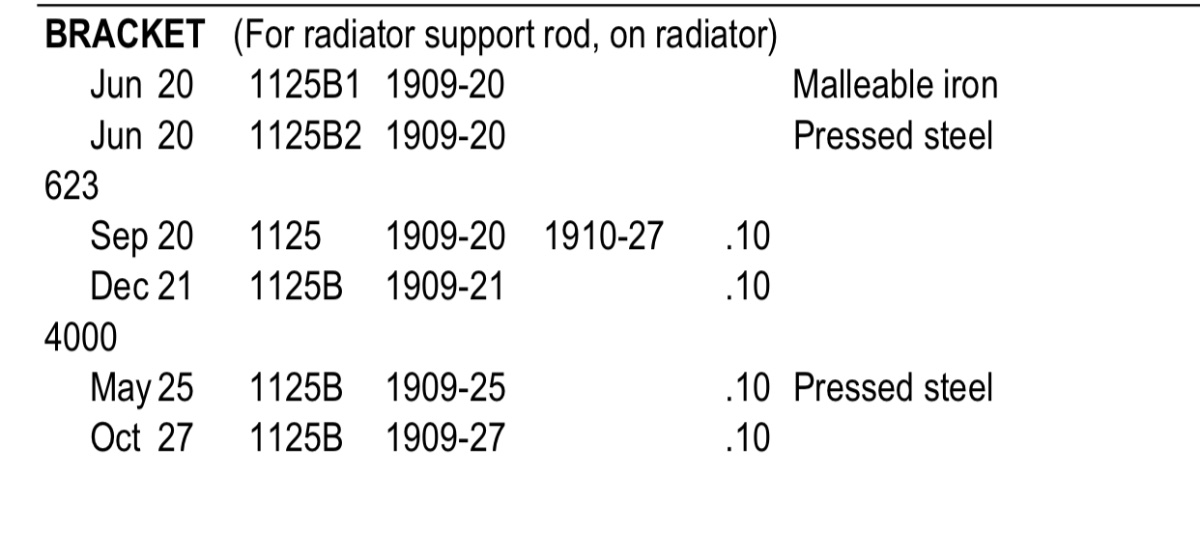

I found a few of these in a box has a Ford script part number looks like T 1125 B
Any idea what this is,
Thank you, Bob

I found a listing for T 1125 B Shown as a TT frame bracket in the parts books. Lang's even has them for sale. BUT, the bracket doesn't look anything like the photo you posted. It may be a tractor part? I have not found much more.

Radiator support rod holder who’d thunk

It’s a radiator support rod bracket.

This piece is riveted to the top tank of black era radiators and protrudes through the rear wall of the tank. It is threaded for the radiator stay rod.

Part # 4000 , Factory # 1125b

Radiator suppert bracket foe me too. These are cast iron, and need thorough tinning when installing them. The threads can pull in them if the locknut is omitted when fitting the rod.
