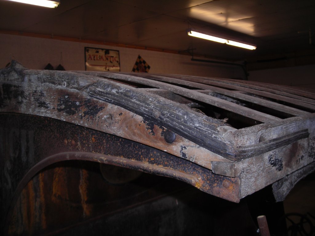

Here are some photos of my original roof that may help you with details.
Justin in Western PA

I've noticed differences in the side header on other C-Cabs - my Gramps' has a 12/23 serial number & has the narrow side headers (if that's the proper name ?) and note the others here have the wider side header - can anyone verify why ?

The “low” roof was the earliest design and not made to stow side curtains. I believe this low roof was discontinued in early ‘24. The “high” roof had storage holes and clips for the side curtains. The steel side panels were also notched at the top to accept the cross bows for the low roof. These sides were installed also on later high roof trucks until the inventory of them was used up.
