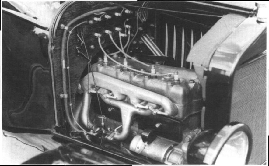

A couple of period photos. Perhaps you can eye the location based upon the other parts near the terminal block. Also shows the route of the loom clamps. Jim Patrick

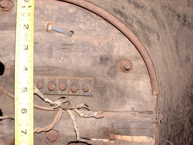

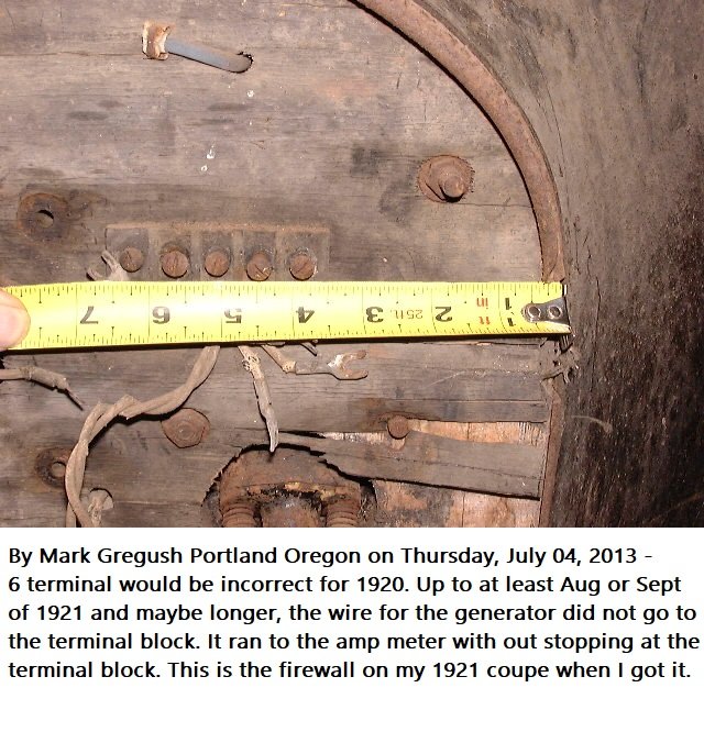

Here are some measurements pictures from this link https://www.mtfca.com/discus/messages/3 ... 72291.html
from another link
from another link
