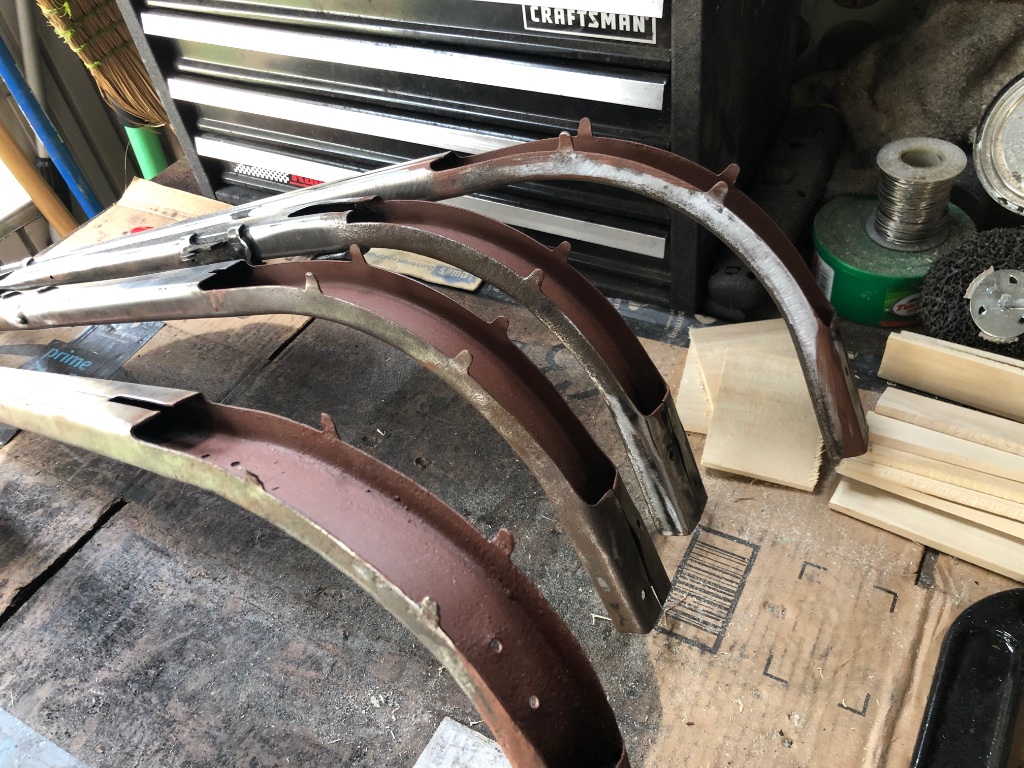

In theory, I think it could be done, but my biggest argument against trying would be getting the top stretched back over the bow properly. If you look at Classtique's installation video, starting at 33:23, (https://www.youtube.com/watch?v=h6Y8gKaKIrs&t=2014s) you'll see the final steps before installing the welting is to trim the top material right up to the line of tacks (or staples). There's not much material left to grab onto if you were to remove it and then try to stretch it back into place. One option might be to try to reattach the straps, pads and top material with the front bow not attached to the windshield stanchions so they're slack, and just trying to line up the holes in the fabric with where they should end up. I don't know if you could get a nice, tight top doing this though. I think before trying to do it this way, I would resign myself to the distinct possibility it won't work and you should probably start budgeting for a whole new top in case it doesn't. I've done a '24 Roadster top and a '25 touring top with Classtique kits. They seem to be a daunting task, and the provided instruction sheets don't offer much help, but their video and several past discussions on the forum made it much easier.
For reference, the corners are steam bent. I used two thinner pieces on each side. I used poplar (I know, not correct). They steamed for 20 minutes in simmering water. Working quickly, I inserted them quickly in the bottom portion of the corner and bent them around to the top. Then they were clamped in several places with C-clamps and the tabs on the irons were bent down. I let them cool and dry for 24 hours before unclamping them. You will want to anneal the tabs first or they can break off.
The center sections are ash. Cut to length and shoulders were cut and rounded over to fit into the irons. The ends look like tenons when you're done. The center sections are then riveted into the irons.
