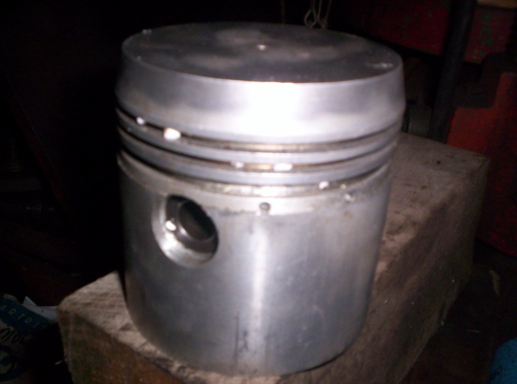

I have a set of pistons that I was told came out of a T engine, the wrist pins are too big for A rods so thought may be chev, so just checking on that, may be questionable, chev at .850"? These come in at 910"
