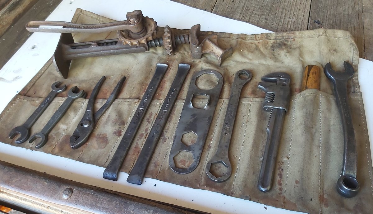

Variations exist on tools supplied with the T. But for a typical late 1922, which became the '1923 Model year', this photo shows many of the correct parts.
Approximate tool roll for '20s'.jpg (145.55 KiB) Viewed 2371 times
Contents of the roll would be:
2 tire irons 2340
1 pliers 1903 Ford script, but no 'USA'.
1 hub cap wrench, 1349 Ford script either flat version, or could be left over earlier version with the flanges around the hub cap and front spindle nut openings.
1 spark plug wrench, 2335 Ford script with enclosed end for for head bolts or demountable rim nuts.
1 double end wrench, 1917 Ford script, smaller size script, and no USA, for band nuts
1 adj. or monkey wrench, 1387 Ford script, but with rounded end, the square end is for later Improved car rear axle pipe drain plug
There would be no separate wood handled screwdriver, that was obsolete in Aug. 1921, the tapered end of the pliers acts as that tool.
Other supplied, but out side the tool roll:
1 Tire pump, painted black.
1 Oil Can, copper plated
1 Jack, screw type cast with attached handle.
1 Owners Manual
1 Current year Parts and Price List

I have heard that monkey wrenches with the square extension on the handle are for a Model A Ford. Model T wrenches had a rounded end.
The screwdriver was gone by 1922. One handle of the pliers was tapered to work as a screwdriver.

Our Canadian sourced cars should be like yours. The open end ring spanner on the plug wrench is correct. The rounded end adjustable wrench likewise. If you have room put one of each variant of the hubcap wrench in. If you find a 3 hole one with tapered sides and a larger circle around the hubcap end, I'll swap you that for a 4 hole one :) Just recently I found a T1917 band wrench like no other I have seen. It is the diamond shaped one, with "Made in Canada" cast in either side and under the Ford logo.
The tyre levers shown in Dan's kit are the usual suspects, but there are others, particularly for a Canadian car. They are a similar size and shape, but stamped into the stem is the Ford logo, made in Canada, and the factory number. [not the part number]. I have one extra of these I could sell.
The screw type jacks we have were made by two different manufacturers. One was Auto Specialties. The more desirable ones have a flip in extension which compensates for the differing heights of the front and back axles.

[Steve these photos show one of my tool rolls.
The tyre levers in the separate photo have the factory number T4069 stamped into them.
The T1917 open end wrench is the one I found recently. I have never seen another with Made in Canada stamped in it.
