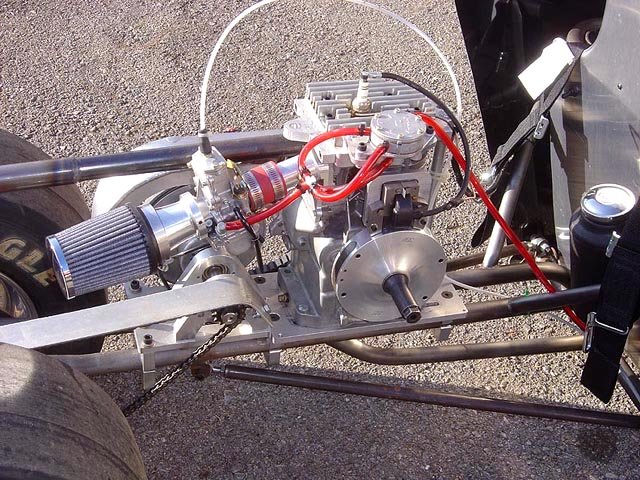

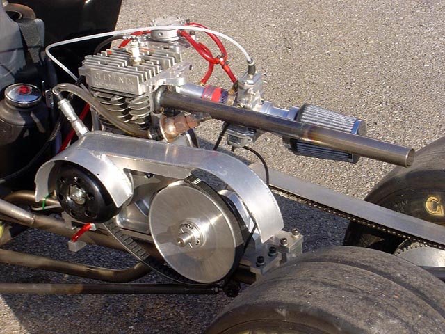

I have experience with this, as I had a small engine shop for a number years. Briggs & Stratton used the aluminum rod design without a bearing on most of their engines up to 28 hp.
These engines single and twin cylinders are governed at 3250 rpm.It was not uncommon to see them with 400 hrs on the meter.
The majority failures we saw were caused by running out of oil.

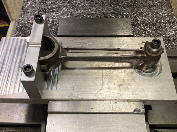

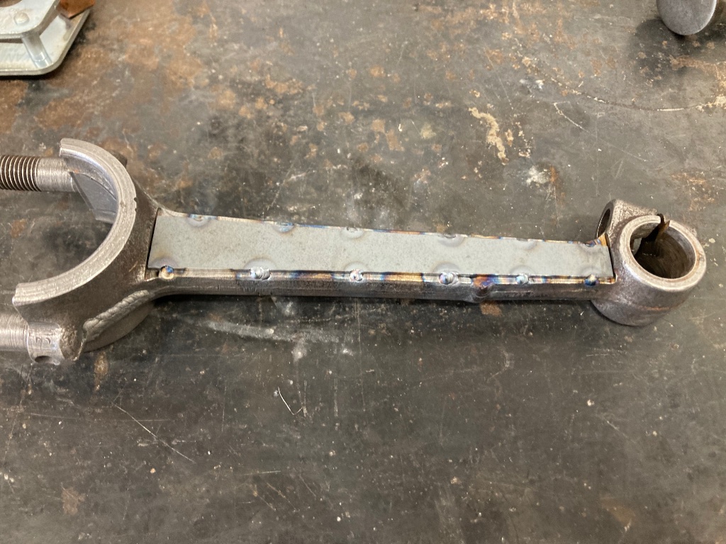

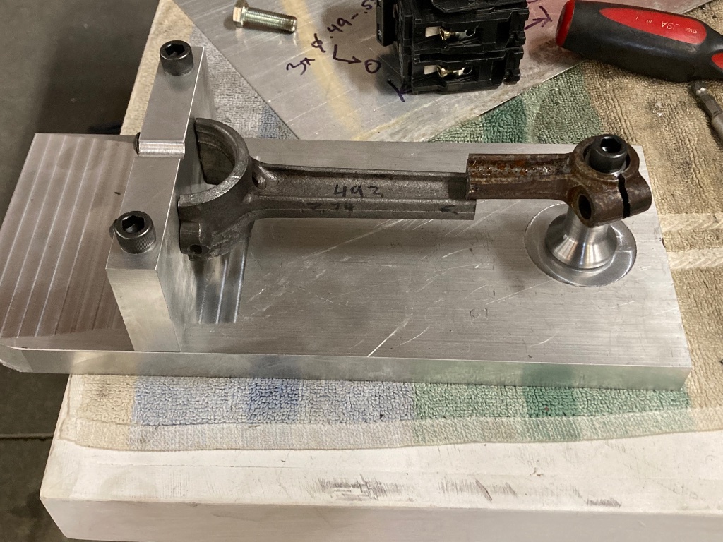

Here is a couple pics of todays progress. Apparently my old rod fixture was lost in dads recent move… so made a new fixture this morning, and started putting pieces together

Re: Welding connecting rods
Kevin
I trust there’s another picture to come??(tomorrows progress)?
Not too sure bout the timeline… but this should be a fairly quick project. My dad should be cutting the other 3 rods while I’m at work tomorrow, and I may be able to get all 4 to this stage over the next couple of days. Once all are to this point, I will rough balance, then start on the boxing plates

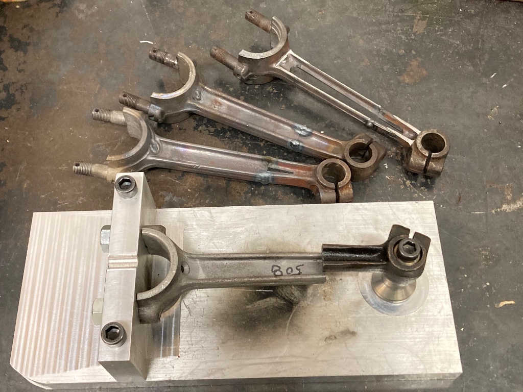

Les, I used to have a picture of a 'rod press' that was used to compact a Model-A rod. Evidently, the rod was heated and then the jig was on a sliding post where the rod was placed into a hydraulic press and then the rod was compacted to the correct length.
Kevin, I like your method of removing the section between the beams and then adding a continuous piece to make a solid beam.

Pretty sure the concept of compressing A connecting A connecting rods was covered in an old Vintage Ford article in the '70's on an engine built by Ellis Gray that was in his '24 roadster and ran at the Long Beach Hill Climb.

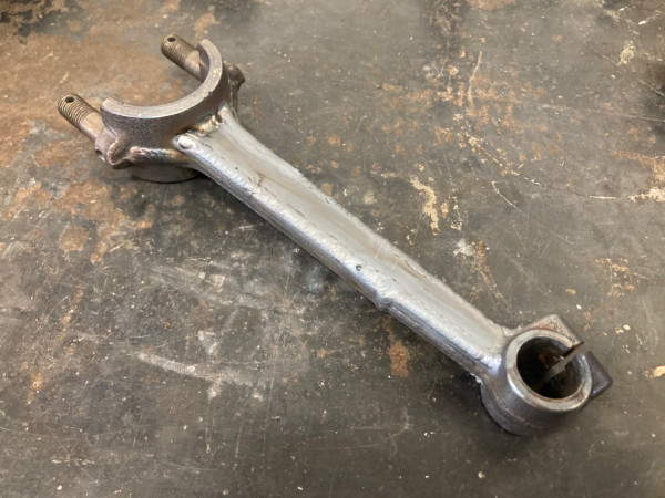

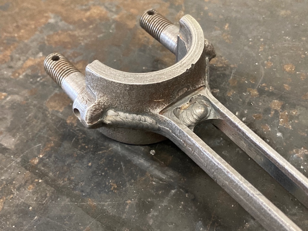

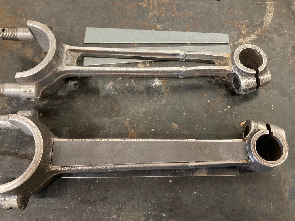

The center web is removed to lighten the rod. Next I will cut 2 16ga steel “boxing” plates that will be welded to each side of the rod, creating a rectangular tube section where the I beam was. The boxing plates create a massive weld surface area compared to simply welding the I beam back together. I would be curious to see how the failed rods mentioned above were shortened, and also hear how and who welded em.BRENT in 10-uh-C wrote: ↑Mon Mar 13, 2023 8:41 amKevin, I like your method of removing the section between the beams and then adding a continuous piece to make a solid beam.

My dad pressed a set of rods a while back… after a complete rebuild, we found that the block deck was about .090” shorter than it should have been, causing the top ring to peek out of the block at TDC. A simple angle iron jig, some localized heat, and a hydraulic press yielded a set of needed length rods with an earthworm looking bulge up near the wrist pin. Not sure I would try squishing the rods much more than an 1/8” tho. No doubt the folks back in the 70’s were trying to use an off the shelf piston, and just needed a small adjustment. If using the stock T piston with an A crank, an A rod would have to be squished 5/8” shorter and then the small end bushed to fit the T piston

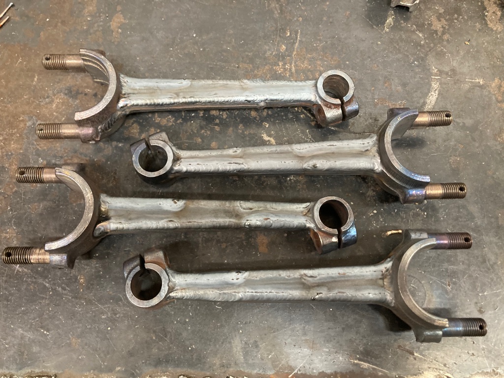

Only got in an hour tonite. Just enough time to fit 2 more rods and weld up the edges. Occasional adjustment is required to align the edges of the rods, so cut down the middle of the web, and spread when hot. I’m also filling the oil holes as the original holes would have broke into the now boxed section of the rod. Will need to drill new oil holes after the welding is complete. Preheat, wire brush, preheat, weld, post heat.
Impressive!!
Thank you
Thank you

Kevin Pharis
- Posts: 1656
- First Name: Kevin
- Last Name: Pharis
- Location: Sacramento CA
Made some progress today;
With all the rods shortened and webs removed, I V grooved the inside of the weld joint and welded from the inside. Also did a rough balancing job which required some grinding, and some adding of weight; Next was cutting the boxing plates; Tacking together; And final welding;
Dave1
- Posts: 130
- Joined: Sat Jan 12, 2019 12:01 pm
- Last Name: Eddie
- * REQUIRED* Type and Year of Model Ts owned: 1926 Tudor, 1926 Touring, 1931 Plymouth PA, 1952 Hudson Hornet
- Location: Lillooet BC. Canada
Looks good Kevin, why do you remove the inner web? is it a weight issue?
Dave Eddie
Dave Eddie
Kevin Pharis
- Posts: 1656
- First Name: Kevin
- Last Name: Pharis
With the center web removed, the boxed and welded rod now weighs within a few grams of what the original donor components weighed
Any heating required, before or after welding ?
Dave Eddie
Dave Eddie
Kevin Pharis
- Posts: 1656
- First Name: Kevin
- Last Name: Pharis
I follow typical chromoly welding practices. Preheat to above 300F and TIG weld with er70s-2 filler rod. I post heat when welding the 2 rod pieces together as the part chills pretty fast. But when welding the boxing plates, the whole part is near dull red when finished, and cools evenly in still air
I’m about 4 hours into the shortening fixture, and 8-10 hours into the machining, fitting, and welding of all 4 rods. Not a huge or complicated project, but attention to detail is important. The next step will be assembling the big end of the rods, straightening, and pre-machining for babbit. The shortening fixture references the parting seam of the rod… and the big end bores are not always where they should be

Kevin,
When are welding the boxing plates to the rod, do you secure the rod in the alignment fixture to minimize warping.
Dave
Dave
Kevin Pharis
- Posts: 1656
- First Name: Kevin
- Last Name: Pharis
Nope. The fixture will not allow access to all sides when welding. You will need to evenly preheat, tack weld both plates approximately 3/4” spacing, then weld all around in balanced segments. I found that welding 1 rod complete is very hot when finished. To the point where controlling the weld puddle can be challenging. Take a couple minutes between the later weld segments to allow heat to dissipate as the rod gets too hot
The rod will need to be straightened no matter what. Do your best to balance heat and the rod won’t warp much
